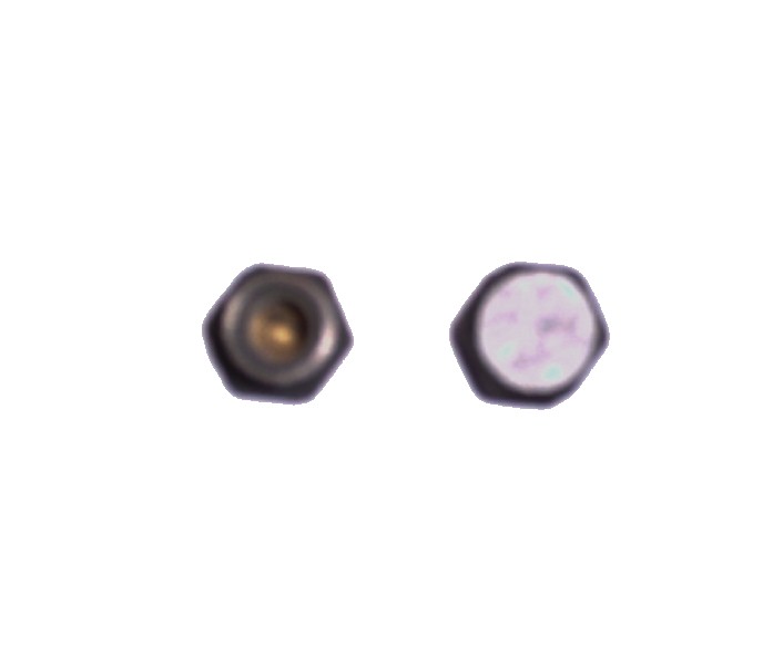

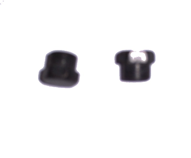

Oh and I can't really find a good picture in either manual I have..what kind of nut, does the windshild wiper arm attach with?..I have a bunch of nuts and such..but nothing in the parts box seems to match.
Here's a couple of pics of the windshield wiper nuts. A 14mm wrench fits them. Hope they're clear enough. The color on my car is code 510 (Sky Blue). Here's a link to member mperdue's color codes. Scroll down the the 260-260Z codes. That's actually the same shot of my car on that page.

Thanks..nice ride! I knew it had to have a threaded sleeve, with a nut on top, but wasnt sure if it would be domed or not. I wonder if that will be a tough one to come up with..better get yard hopping LOL.
