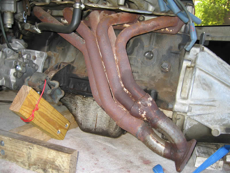

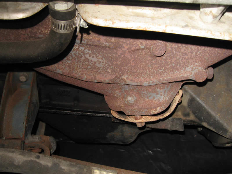

First off is the header. One reason I bought this was for the muffler (which I had to replace). The new one looks to come with a 6-2-1 (I think) which is made to go with the muffler and exaust. How much better is this one than my other one on my car. (referance pictures below and sorry for the bad shot on the header in my car, it's the best I could do)

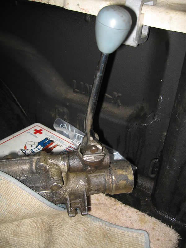

Second, I have a reciepts that came with this engine and one of them is for a short shifter. How can I tell if I have this option added to the trans? How hard is something like this to remove and add to my car?

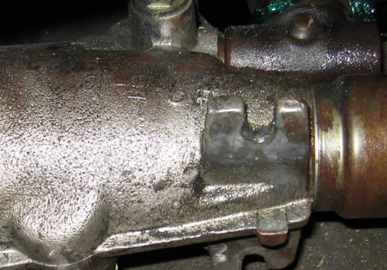

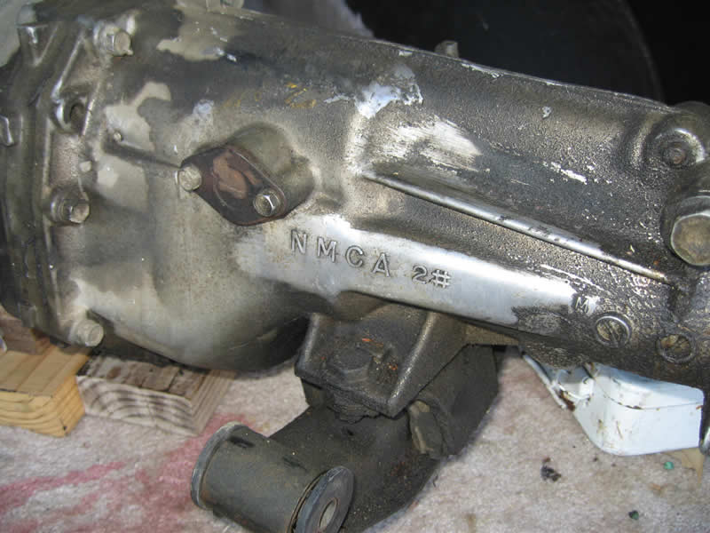

Third is the transmisson. The one I have now is also a 5-speed, but I would like to know if this one is anything special (I am pretty much a newbie to engine stuff, but I have included two pictures below to help)

The first pic is a set of headers that you got right? the second pic is the exhaughst manifold on your car right? If so then switch to the headers in the first pic. Only if you have the right exhaust ports (some are round some are square). You will have to find out what the head number is on the heads to find this info. If they are the same then great. the head number is located between #1 and #2 spark plugs. Something like E31(would be nice :love: ), E88(would be nice :laugh: ), N42(not bad ROFL ), N47(the worst :tapemouth ), P50(good :classic: ), P50A(better :cheeky: ) would be there. It is raised a little bit above so seeing it should not be hard.
As for the sort shifter that is not hard to change out at all. I personaly think it looks like a shifter from a ZX but I maybe wrong :stupid: . Check out this page for info on changing this item out. http://www.atlanticz.ca/zclub/techtips/shifterbushing/index.html Just a snap ring, pull the pin and out comes the shifter. Its not that hard. I just did my on the 76. I ended up using the HELP kit # 38388 took a drill and a 11/32 bit and drilled out the shifter and grinded the bushings just enough on the bench grinder. I had an extra transmission sitting in the shop next to the grinder so it was simple. Made a great difference in the way my tranny shifts.
The tranny is not my best area but I do know there were 3 types 5 speeds made for the Z and its BIG Brother the ZX. One was the early type that really was not very good due to the fact it has problems loosing 5 and reverse. The second one was better in quality and Nissan I guess fixed this problem. There is no way to tell these apart from what I have been told and read. The third one is a T5 borg warner. This came in the 83 ZXT I believe. It is very good and very hard to find. It is also very difficult to put in the 240 260 and 280s but worth it to me.
The header is a P90A. The first photo is of the 6-2-1 header on the engine I won and the next one of the one on my car. I think I labled the file names to help identify the photos. Next time I will add text in my photos :P to help.

Yeah the header would be better than the stock exhaust manifold which you have on the car.

I went and looked at the engine in my car, it has an N42 in it with a stock exhaust manifold.
The engine I just got has a P90A with a 6-2-1 header. Now is this an easy swap out or a bit more complicated? I would really like to use this new exhaust system as it is quite nice, but my old engine has had a fresh rebuild. I am not that mechanicly inclined when it comes to engines, so bear with me if I ask some stupid questions.
