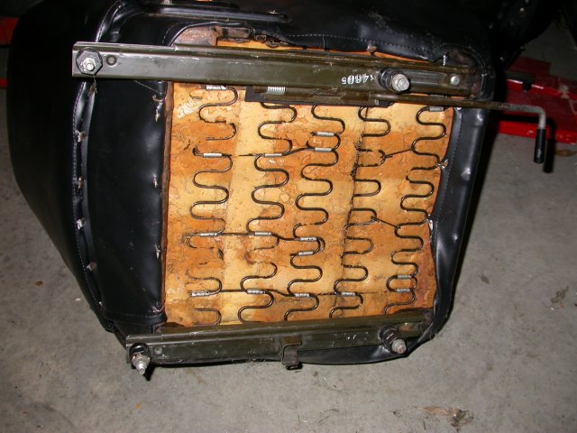

The strap kit is meant as a replacement for the straps that Datsun used instead of springs in the early 240Z's. The seats in my '71 have no springs, only the straps (which are rotten, I will replace them soon). I don't think the straps will add any support to the later seats with springs, assuming they can be installed on later seats at all.
Arne is right. Straps for earliest 240z's, springs for later 240z's (approximately 6/72 production date).
as for the foam sets, they are made to approximate the shape of the OE foam. True there isn't much in the seat bottom and it wouldn't be too difficult to come up with something that will work on your own, but the sets are very handy for replacing the foam in the seat back.
Thanks, gents. I hadn't known about that difference, early vs late. FWIW, the springs and the rest of it are the same on my '73 240 as they are on a seat I pulled out of a 1976 280. Just some differences in the way the slides get attached to the seat.
With the metal springs, it looks like a guy could tie some of them together to increase the level of support, maybe bring it back more to the original level. A few are tied together in the first place. You wouldn't have to tear the seat apart to do this.

Here's a pic of the Seat I took out of my 240Z. As you can see, it has the springs, even though the car is an 11/69 build, which tells me that the PO has replaced the seats at some time in the past. However, on the foam, you can still see the cross-hatched impressions from the straps that were original to the car, so he obviously used the original padding on a newer seat, without the straps.
I know he "refreshed" the car in about 1992, which was before, I suppose, new seat inserts were available.
FWIW.
