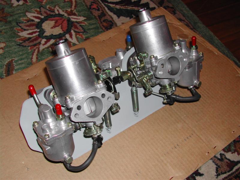

Here's a pic of my SUs just for fun. They look like nasty flat tops but they're relaly the same as round tops (notice they float bowls aren't integrated like on the crap Z flat tops). These are 510 SSS carbs, desmogged :) Had to get a manifold from Australia because they never had A series SU's in the US, only JDM and Oz as far as I know.

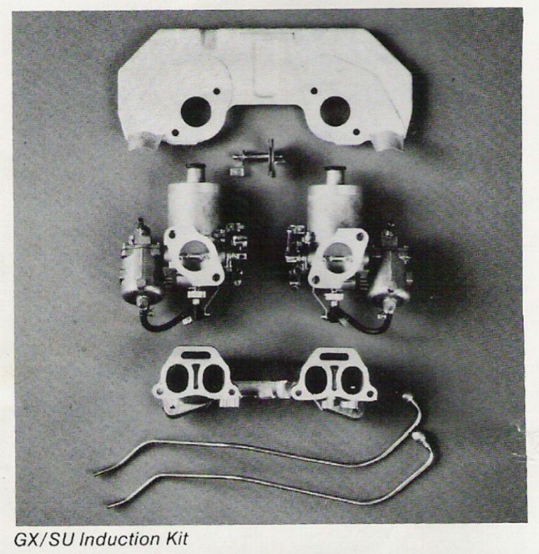

Actually the GX setup was available here in the US form Nissan Motorsports. It used the 38mm flat tops which are not smog carbs. This is a scan from one of my old Nissan Competition Parts catalogues. Doesn't really answer your question but that setup was once available here.
Wow, awesome bit of info Stephen - thanks! I hadn't heard that they were available here even through Nissan Motorsports. Hope you don't mind if I relay this info to the 1200 forum. They may find it interesting as well. I wish there were a picture showing the manifold so I could compare it to mine. If you have any more info on this please pass it along to me (off line if you like so we don't post too much off topic stuff here - I try to limit my non-z posts at least to info that is directly applicable to Z's...)

Michael, I'll be in my garage this weekend and will take some photos for you. Regarding the e-bay auction tou sent me to, those tubes are for "banjo" bolts (metric at that and tough to get), while the photo of your carbs shows hose nipples for the breathers.
So, not directly compatable.
I thought those connectors looked a little weird. Well I've got a tube bender so maybe I can come up with something that looks nice myself. No huge rush on the pictures. I can only work on my car for a short time on Saturdays anyway and I've got lots of wiring to straighten out anyway.
