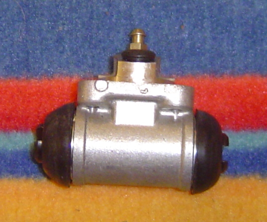

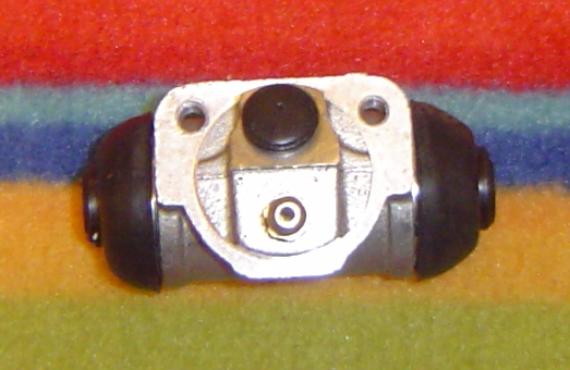

I have the opposite problem now. I have the part with no part number. I know it's a wheel cylinder that goes on the left side of the car (there is a really tiny L on one side).
Anyone know which model and year this goes to?
Thanks!

Well, that doesn't look like the ones on my '73...
LOL that rules that model out...
Thanks!
