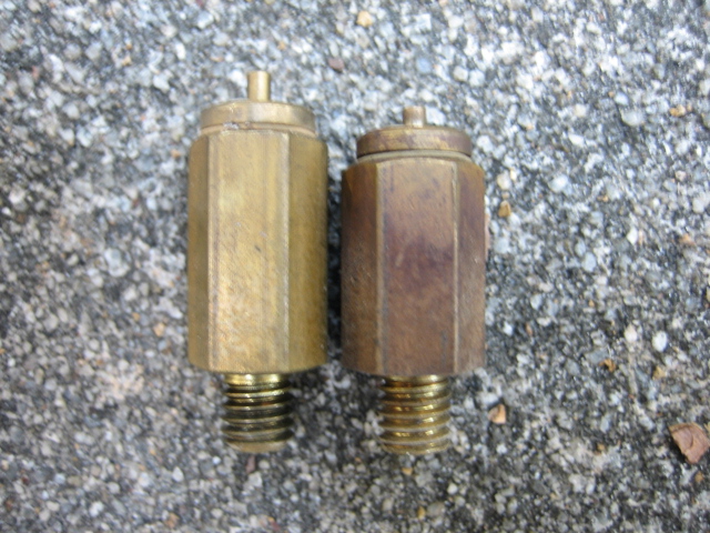

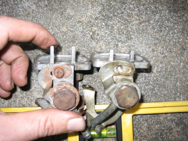

I took apart part of my carbs today to find out that I have different size jets. I also noticed that the towers(?) that hold the float pins are different heights. The smaller of the towers had the smaller jet.
Is this from two different carbs?
Also, when I go to set my float level should I compensate for the different heights or just set them both to 5.5mm? Obviously, when I hold them next to each other to see if they are equal, even if they are both at 5.5, they won't be.

Seem to recall something on ZTherapy's site about the different ear sizes. Certain years had different float caps for front and rear carbs. The different length needle jet may have been to go with that, don't know.
But regardless, the needle jets are only to open the float inlet, they have nothing to do with the mixture. (Not a true jet, in the normal carb meaning.) You should still set the float level even in both bowls.
You are absolutely right arne. I had looked over their site before posting this, but I missed that part. It is amazing how many parts they mixed together.
Thanks again!

I took the Ztherapy info to mean that the different size ears where contained on a single float bowl cover. It looks to me like you may have two different version carbs. And that's all I'm gonna say as a newbie who has yet to crack his own carbs. :)
Could be, my carbs are early ones and both float covers are the same. But I also note that MSA's catalog lists a different "needle valve" (proper term for what we have been calling "jets") for the front and rear carbs for a '72. So I'm leaning towards the original poster having a matched pair of '72 carbs.
