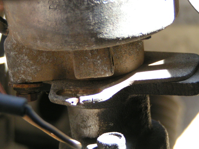

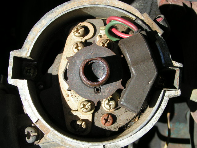

It has a magnetic pick up dist. with the numbers D6F4-03 7303 22100 N4301 marked on the side. It has vaccum advance and the wrong timing plate/base?

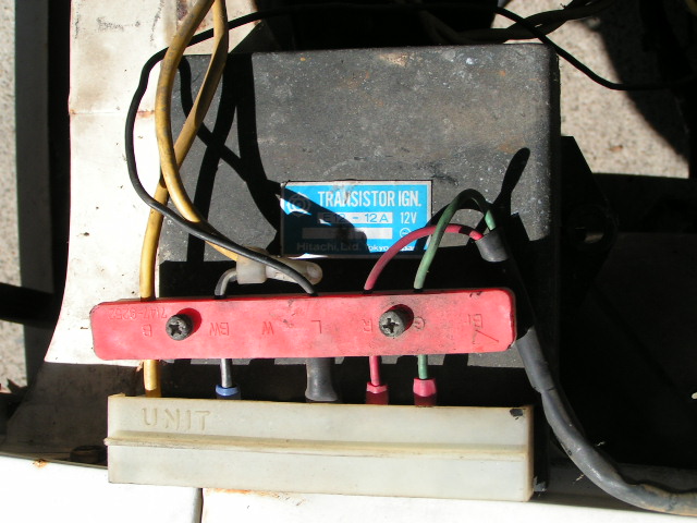

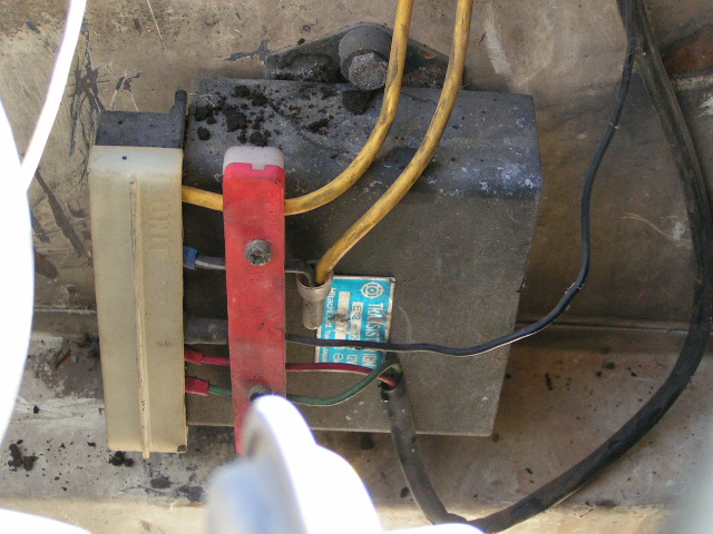

The spark box is mounted on the firewall with HITACHI E12-12A marked on it.

The pevious owner said his brother put it on so I assume it's installed wrong or dont work?
Here are some pic's of them maybe someone can identify them and sugjest the correct instalation or some test procedure.
