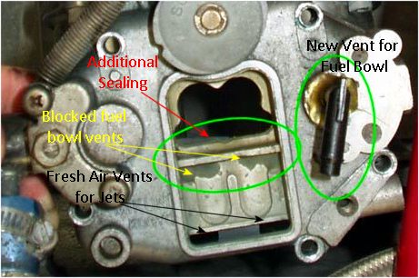

An old thread but it just happened to our club racer so I figured I would try to simplify the great info above.
From what I understand:
Basically in right high G corners, the fuel sloshes to the left side of the car. Inside the carb, the sloshed fuel works itself up through the fuel bowl vents and gets sucked into the top of the air jets (which are supposed to suck air, not fuel).
The problem is that Mikuni has only one fresh air inlet into the carb to feed both the jets and to vent the fuel bowl.
The mod basically makes the stock fresh air inlet only for the jets and a new system is used to vent the fuel.
Edited by Blue

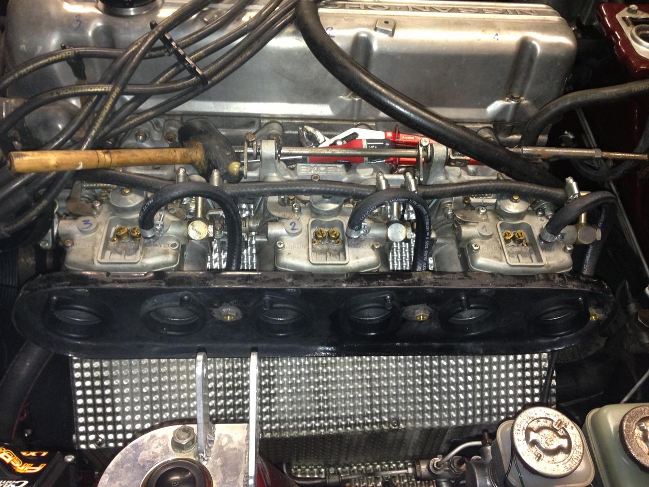

Hi
I have exactly that issue with my S4 triples
I have added a surge tank
It is better but not perfect in high G right cornering
And I was on the way to lower the fuel level for a second time...
Finding that post is great!
Many thanks for sharing
  • 7 months later...
It tooks me a bit time!
Here are the mods
I still have trouble with air sucking on main jets
It works only without the jet cap...
But that goes in good direction :)
Edited by Sylv1
