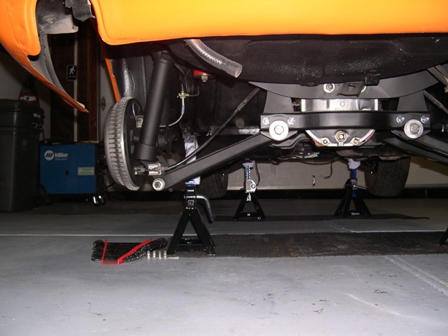

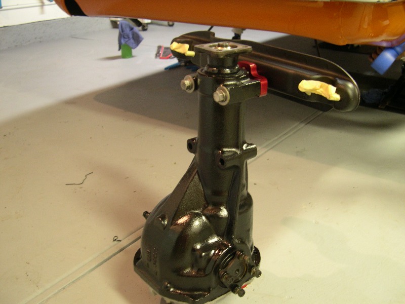

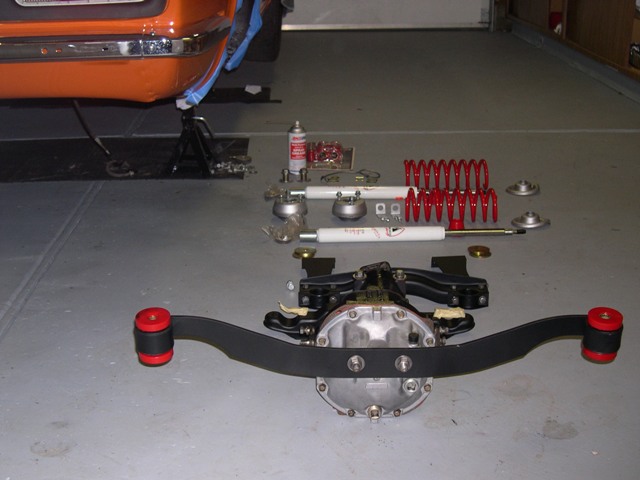

Hi,
I have replaced my rear end on my 70 with a R200. I was in the process of restoring the drive shaft i bought for it and found out it was not servicable. Evidently the u-joints cant be replaced. Does anyone know of what year shaft i need to look for that can be serviced of if there is a place to buy aftermarket or custom. If anyone has one for sale, i would be interested.
Thanks
Mark
