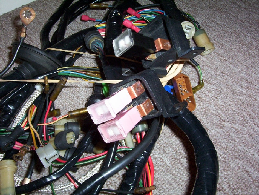

I am currently making up some new spade connecters to either bolt or solder to the original spade connecters so that I can utilise modern cartridge type fusible links in lieu of the old style wire ones but keep the original holders and covers. I'll take pictures along the way if anyone is interested.

Three hours work to make and solder new connections and job is finished. Unless you remove the covers you would never know it has been modernised.

I agree, Alan. If the harness gets hot enough to melt solder you better start RUNNING because your car is on fire. I'm curious as to the advantage of the change over.
The advantage for me is the availability of the new style cartridge type.
$2.95 each, and available everywhere as opposed to the old wire type which are hard to find these days. I also have too much time on my hands I think.
