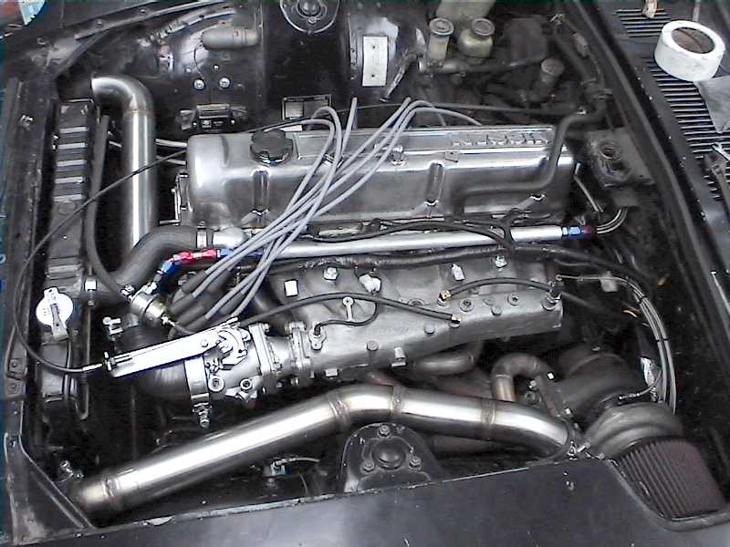

I would hazard a guess that the ones you have seen haven't been running the standard computer. I brought an L28E manifold and immediately ripped ALL the crap off it as I didn't need it, see attachment for what it looks like now.
Aftermarket ECUs typically don't use the cold-start stuff that you find on factory systems. Though ECUs these days are allowing for idle stepper motors and what not. Basically, everything on a factory system is there for a reason, don't go pulling things off if you don't know what it'll do.

I have removed a few things from my intake manifold and it looks a lot like tthe photo from thehelix112. I still have injector wires, cold -start injector, and the aux air valve system.
