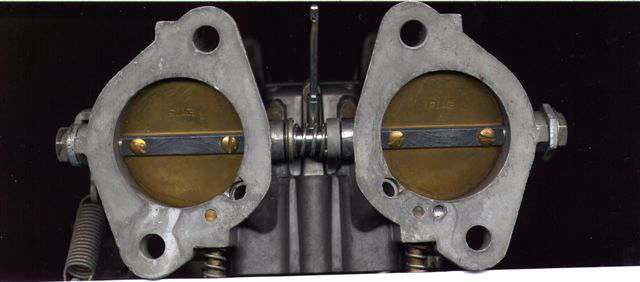

Here I have a picture of my carb, you see there’s a ‘hole’ in the outlet (to the manifold).

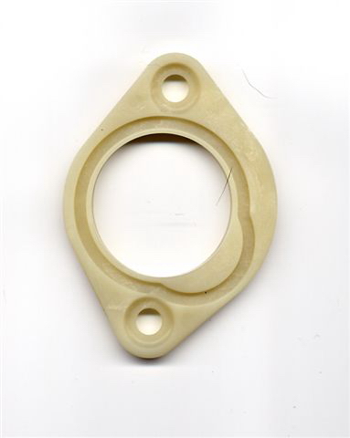

Can anybody tell me why is that for? Secondly I received a mail with the following kind of insulator, (second picture)! I presume this is a new type of insulator with a rubber seal in it, because normally you only see the aubergine coloured insulators? But why is the ‘island’ for and is it a correct type.

To try and answer you queston, I have the older style Mikuni carbs but I believe that the extra hole in the carb is for the Idle air, not sure. The insulator block pictured is the new style anti-vibration insulators, a rubber o-ring fits in the cut out in the insulator to form a seal and cut down on vibration transferred to the carbs from the engine.JLP
