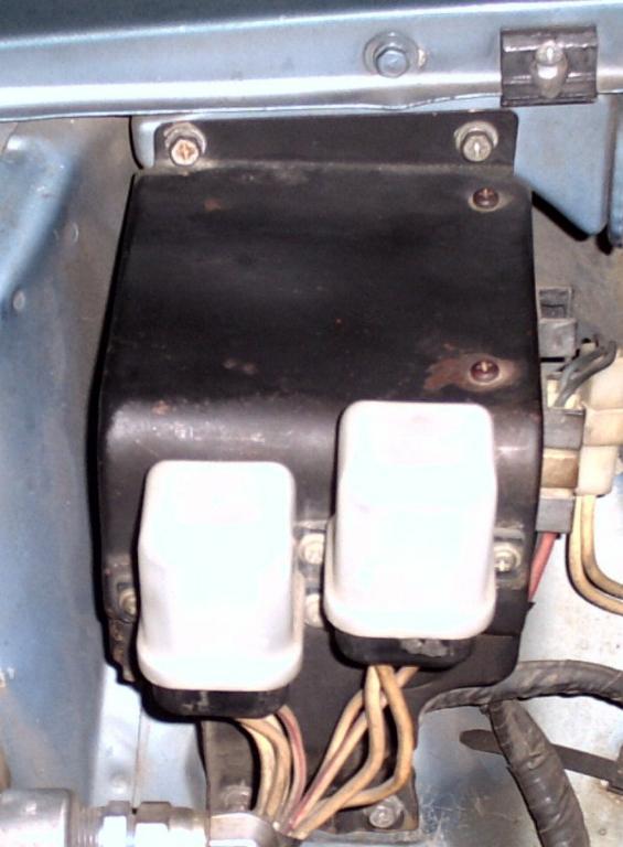

As some of you know my 77 2+2 is a rough ride, and in getting everything to work to find out if it runs, i need some help. The fuseable links, what are they and where should they go. I already downloaded the wiring diagram for the car, its a huge help, but i dont have the covers for them and the previous owner has bridged them together, 2 separate bridges. Is this how they are supposed to be?
https://www.classiczcars.com/forums/topic/13737-77-280-22-help/
They are in a little box on the passenger side of the engine compartment near the strut. Pop the cover and you will see two short thick wires-those are the fuseable links. They should be seporate. The two outer terminal connected together, and the two inner terminals connected together, (inward is toward the engine).
I am not sure if this answered your question, but I wanted to try.
