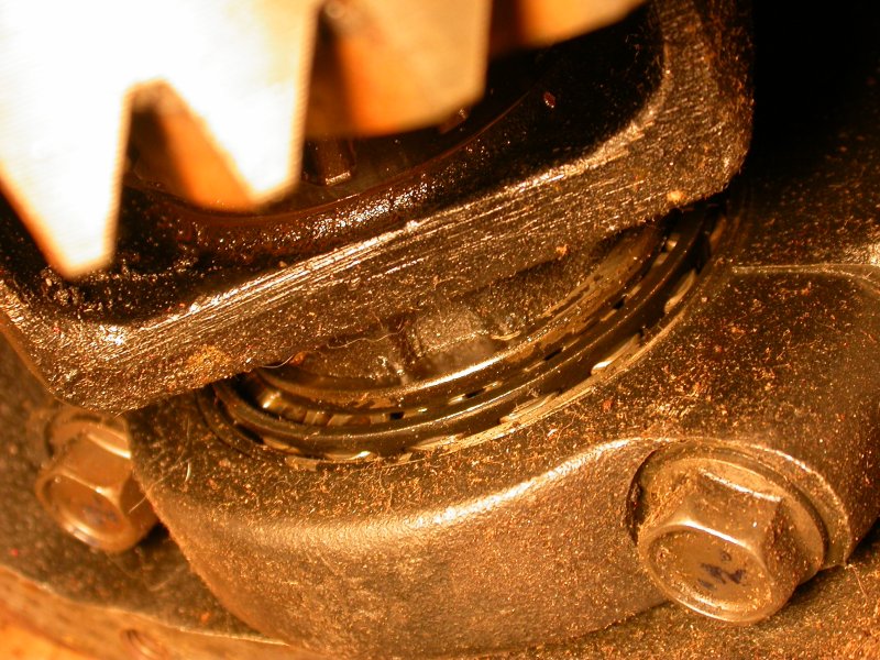

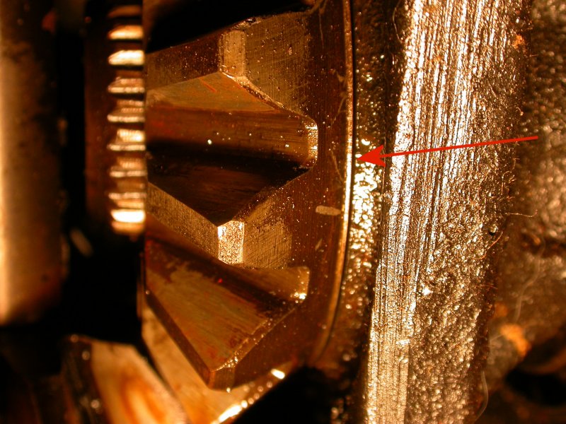

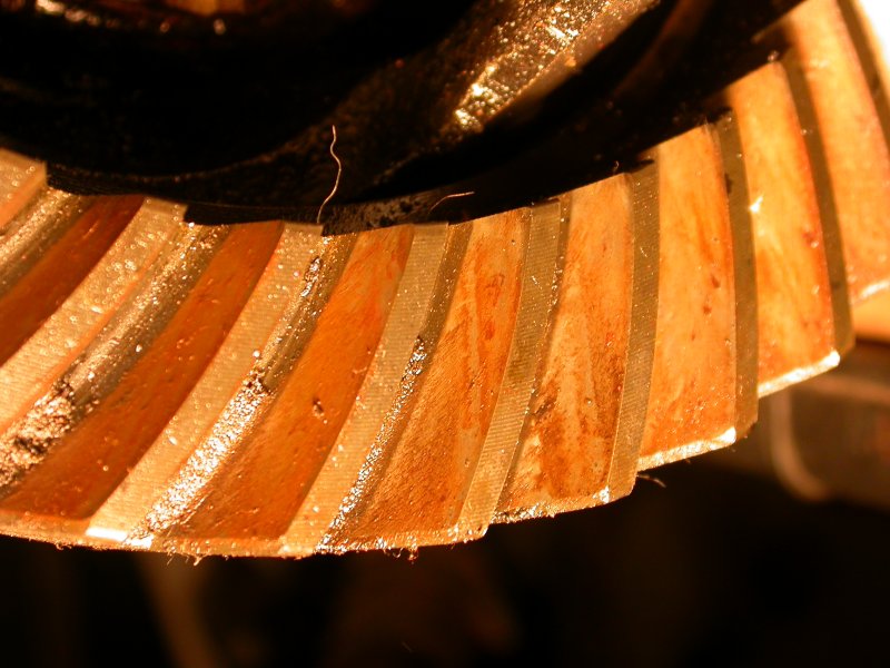

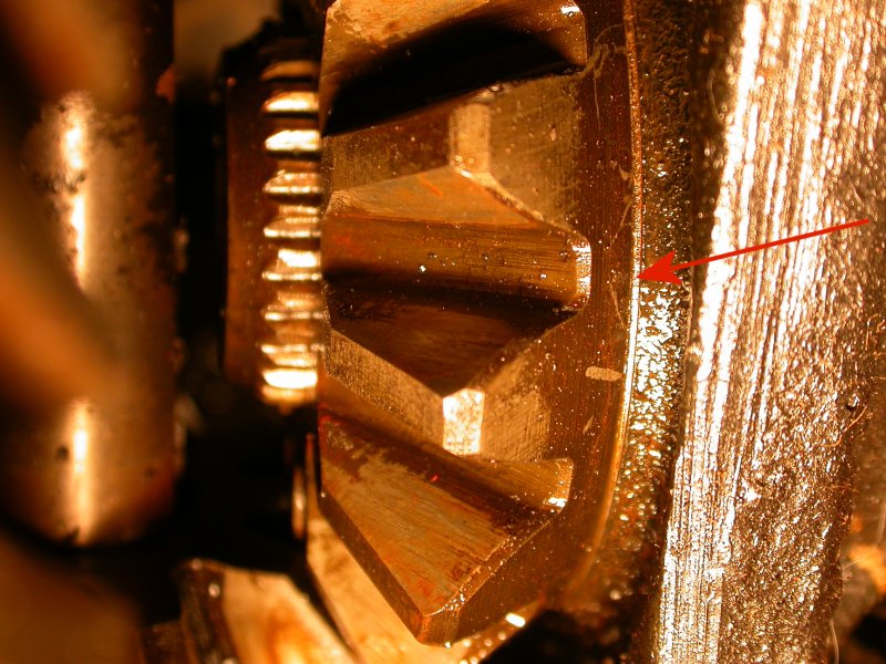

Ok, to continue this thread... I've been exploring the diff, and I have one potential problem, and a few pics. The potential problem is that the RH flange and shaft has a lot of runout and movement compared to the LH (the LH essentially doesn't move at all in, out, or laterally). The RH shaft will move in and out 0.05 inch or more. In the picutre I've attached here, you can see a small gap between the thrust washer and the gear carrier when I push the shaft all the way in. In the next picture, you can see it closed as I pull the shaft outward. The whole assembly kind of "rocks" a little too. The third pic is of the RH bearing. Note that as I "rock" the shaft and/or pull it in or out, the rollers in the bearing don't move at all. Maybe I don't fully understand the geometry. Finally, is a pic of the ring gear teeth.
