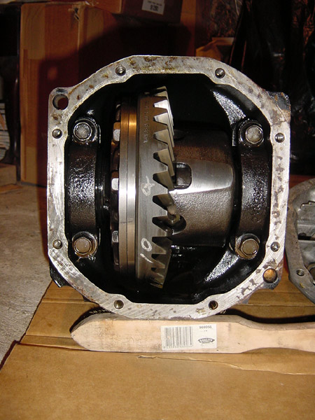

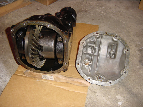

Here's a pic of one of my LSD-equipped R200's with the back off:

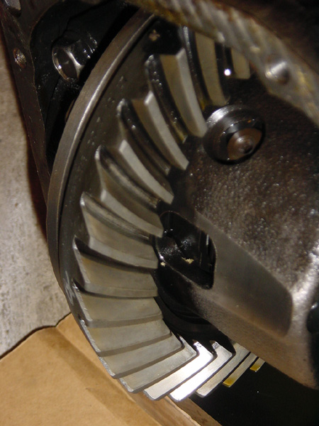

A close-up shot of the Ring gear and LSD housing:
I am sorry I did not make myself clear, I can handle figuring out the lsd stuff, I need help deciding from a picture and possibly a casting number, what that rear end might be. Can anyone help me with that?

You should have said that you were talking about the 'Short Case' R200 rather than the 'Long Case' R200 in the beginning. It would have saved time.
But I still don't understand the question. The internal parts of the R32-type R200 are not designed to fit in the earlier ( long case ) R200, and you would struggle to fit the complete R32-type diff in your Z. What is it you are thinking of doing exactly?
If you want to have an LSD-equipped R200 with a suitable ratio that is a virtual bolt-in for your early Z, then I recommend that you look for the earlier long case type and forget about the one in your pictures.
