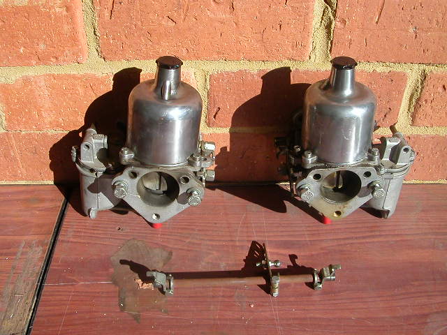

I have a pair of SU's I want to list on e-bay but I need some assistance in describing them. They are British SU's and have the following numbers stamped in various locations PDC2A, AUD9, AUD2140 and AUD2277. They are only a few years old and are in perfect condition (Photo attached).
Does anyone know if there is a generic model number that I can use in my advert tag?
Thanks in advance.

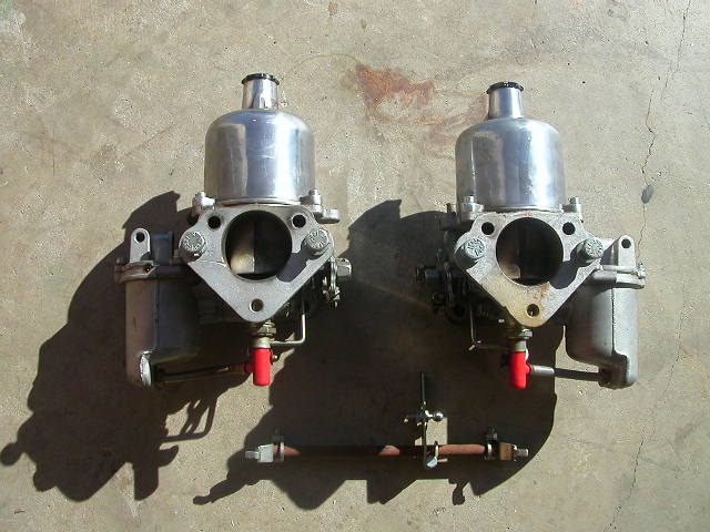

Oops, sorry. That wasn't from the other side. I'll post some other photo's later - got to take them first.

#1 I could not find any of the numbers you listed in the SU bible. More than likely these are individual piece part #s.
The carb # is normally on a little tag under one of the float bowl lid screws. Doesn't matter much as most of the differences between carbs of this style is linkage and metering needles only.
If they fit a Z then they are 1 3/4" which would make them an "HS-6". That linkage because of it's length looks like the set came off a 6 cylinder something......
They also are a 3 bolt face for attaching the air cleaner. They came in 2 bolt also.
So I'd say "HS-6 3 bolt origin unknown". Anybody familiar will go from there, those not that familiar probably shouldn't be looking at them in the first place.
Hope that helps....
