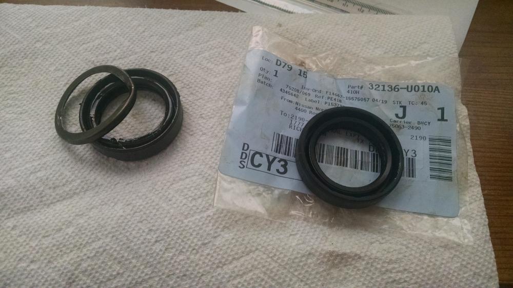

I had issues getting my rear seal out, and partially destroyed the previous seal. Scared that I might do something like this thread, I stopped... and purchased the Lisle 58430 Shaft type seal puller.  I had to find a way to prop it against the housing, but i used a block of wood and rigged it up and pulled out the seal successfully.
When I got it out, I inspected the previously installed seal and it appears to have a metal ring built into the back side of it that my new OEM one does not. I crushed this when removing, but figured if it was necessary my OEM seal would have had it.
Is this just a particular feature of the original or possibly aftermarket seal that was installed previously? or something I need to source and use for my replacement?  Images of the original 32136-U0100 lead me to believe it might have been built into the original and possibly not required to replace with my new  32136-U010A version.
