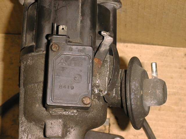

I recently got a distributor from a GC211 Skyline... Now i figured it had an E12-80 module on it... I even asked the guy about it, something along the lines of "does the little black box on the side of the dizzy have E12-80 on it, because if it does I'll have the dizzy."
Anyway, long story short.. it doesnt.
The whole distributor is a Mitsubishi Unit, the Module still has 2 spades however, and they're still labeled C and B.
Now the Dizz was running fine as far as I understand it on the Fuel Inj. L20A GC211, so theoretically the conversion should be the same as if it was the same dizzy and module conversion from a ZX to a Z.
But I thought I'd ask and check with you guys before I went and tried anything incase there'e something stupid I'm forgetting or missing out.
I have the coil from an R30 with a different ignition system, but still electronic so I'm sure I'm sorted in that area.

I've attached a picture of the distributor
By what you've said you should be fine; L20A - L24/26/28 shouldn't be any different unless wires off the dizzy run into the EFI circuit somewhere; by sounds of it it doesn't so you'll be OK.
R30 coil, elec dizzy, B wire goes to + terminal, C to - on coil.
