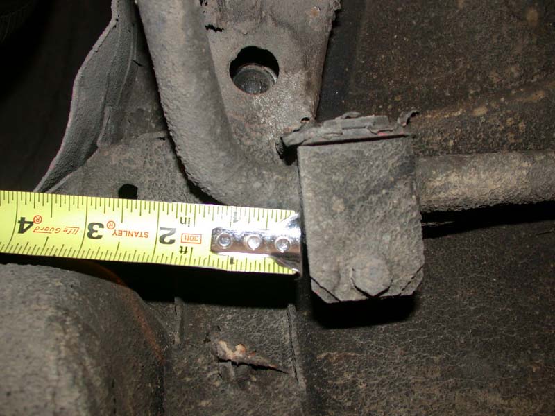

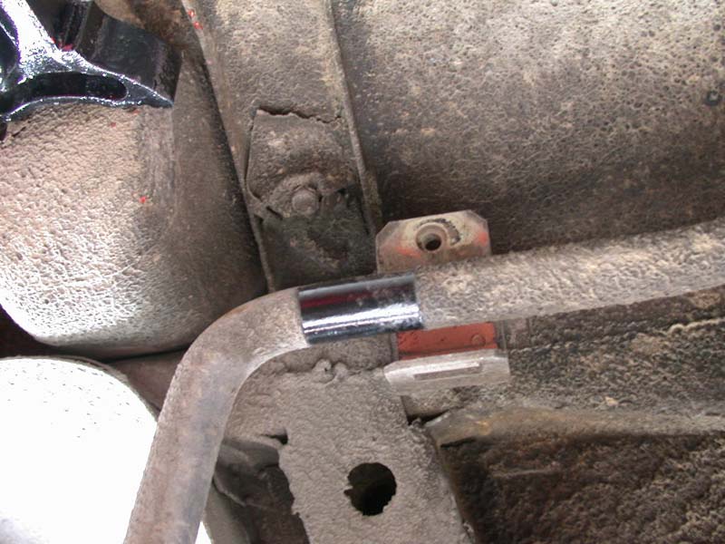

When you get to the rear can you take a photo and/ or measure where the brackets mount.Not all Z's came with rear sway brackets. mine didn't .I have the brackets and need to know the position to weld them. Thanks for your help! Daniel
Daniel-
Here are a couple of picts of my swaybar location on my Z. I have a 260 if that matters (I don't think it does?). I hope this helps you. This isn't the easiest place to get a good photo.:)
Here's another pict with a tape measure on it for reference. I think the first picture is pretty clear as to the location of the bracket. You can see the clean spot where the bushing was before I replaced it.
Thank you oh so much for your timely and accurate photos!!! Daniel
