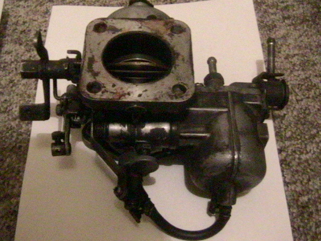

ok right on top of the little fuel wells it has Brittish SU Carburettor company writeen on there (or something along those lines) it also has the 3 screws...
Also i have no idea how to adjust the floats and the carbys are now in my car....
the numbers on the inlet manifolds are N36 (water cooled)
and the head is an E88...

so the jap carbs are a better than the brittish?!?! whats a decent seccond hand set worth???
i dont have much money as im only a young kid (17) and this is my first car and i pretty much spent most of my money on a new engine for it... so if theres any cheap options i would also like to hear them... but i dont want to comprimise performance really

Hi, Mellow
I prefer the Jap SU's because I had a set once that
where in good condition and I was able the set them up to
run the way I wanted. ( Lean or rich )
It depends on the condition of the carbys first then the setup
procedures. If you get the both good your home.
The Brit SU's I had before needed an overhaul thats why
they were cheap. It was just a bad decission I'd say if they
did not need an overhaul they would have been OK.
The carbys you have might be OK the Brit SU's. The only way
to know is to is to put them on and get the engine running.
Then take them to a Mini wreakers and ask questions. They
will be able to help normally if if not busy they like to help.
I'll send you the info I have on the 240Z SU,s if they are same
layout with the mixture needle at the bottom and the float
chamber on the side the same setup should help get them
running. Taking them to a place that works on them all the time
will confirm any problems with the SU's.
Hope this helps with your decission
You have two sets the 260Z and the Brit SUs normally what
happens people take the 260 carbys off because they don't
know how to set them up or because or they are shot.
My quess is the Brit SU's are the replacements. Put them
on and see if they are any good. They could be OK. That
will save you dollars. You will Pay $250-$350 for 240Z
carby's from wreakers and you might pick up a set that
needs an overhaul? Hit our Miss!!Overhaul Kits sell for
$150 US then you have shipping on top $40 to $150 US.
Taking that into account Ztherapy sell them around the
$550 Mark reconditioned.
Carb specialist in Adelaide Charge around the $550 AU
to overhaul the British SU's if my memorys any good.
See how you go with the Brit carbys if they need an
overhaul. I would sell them Cheap for $200-250 and put
the rest to it for 240Z Carby's form Ztherapy. Peace of
mind you Know what your getting then.

youch, well i dont think ill be buying a 240z set of carbs...
ill see how theese britt ones go...
i know the britt carbs work (they ran my old motor) but how good is the thing, well i spose ill try & get my new motor running & get the carbs tuned up & see how it goes from there.
