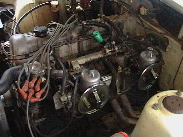

How about you take some engine bay pics? That way we may be able to spot any obviuos errors...if there are any!

Here's a pic for interest. Not very clean I know, but I'm not complaining, she kept the rest of the car perfect :classic: Pity she didn't buy a Zed instead hehehe
