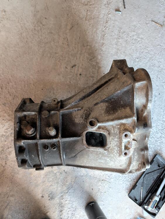

Currently doing the 71c swap and modifying my bellhousing. I've machined down the inner bearing lip to 0.48" and was looking at the reverse switch relocation information.

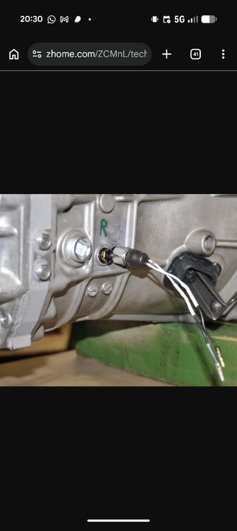

The image I saw on the zhome guide shows it's been moved 22mm back. Which is fine. But in the image it looks like mine is already where they have moved theirs to?
I checked the bellhousing for my 71c I'm swapping to and the reverse switch is the exact same distance from the sandwich plate on both...
Pic 1 is the image on zhome
Pic 2 is my 4 speeds bellhousing.
My main question is. Am I being a tool and I've not realised my original gearbox is a 5speed? The old box has the inspection panel ontop with 6 bolts which looks like all other 4 speeds...
