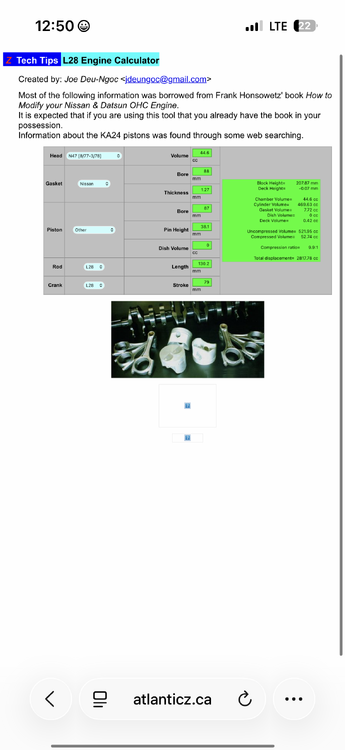

Looking to build my 1980 280zx engine. Engine is already pulled and has a N42 block and N47 head. I’m looking to bring the compression up and run a little hotter cam. I plan on it being out for a minute at taking time on it. What I has looking at doing to it.
• 40 dcoe triple webbers
• port and polish heads
• cam with heavier springs ( new lash pads, rocker arms ext.) Lift(In/Ex): .480/.480 Duration(In/Ex): 274/274
• header to 2.5 in exhaust
Not sure if going with 87mm flat to pistons to get compression to 9.9:1or milling the head .8mm would be better to get the compression up near 10.1 would be better
Any experience in doing this or info I’m missing is helpful. Thanks in advance
