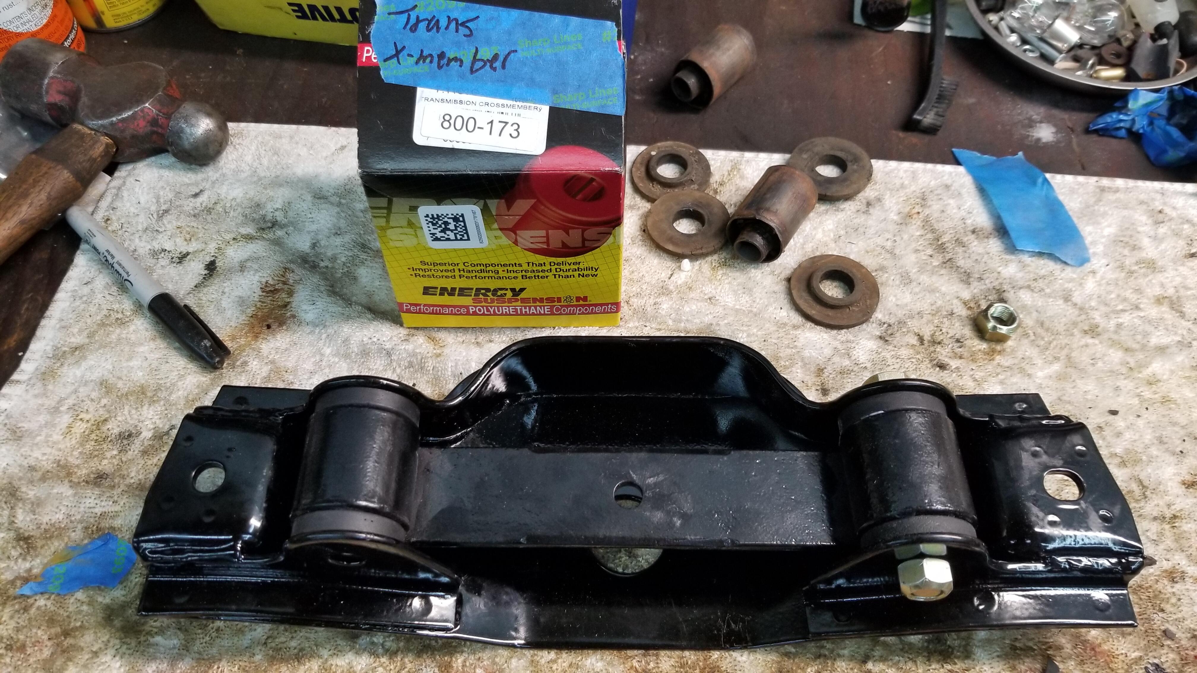

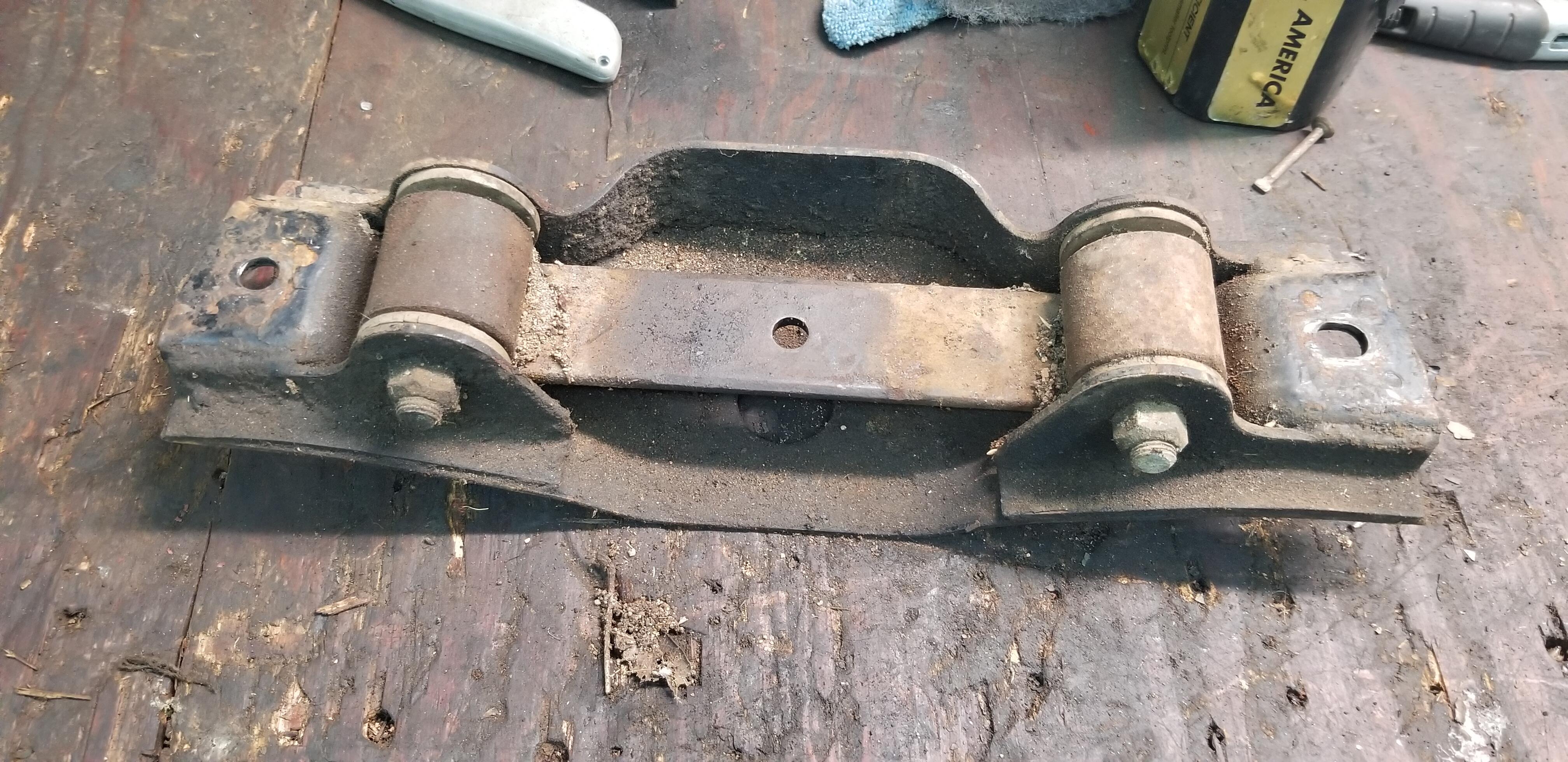

My tranny crossmember bushings were shot, so I pressed them out and read tons of posts on the OEM bushings being NLA. I have a couple of different x members from various years, so I figured I could get something to work. I chose to keep my original x member and make a set of poly bushings work.
I ordered the black energy suspension bushings from one of the vendors. They are too big and too long for my style x member. I took them over to my brothers house and we put them on a lathe and turned them down to the right diameter and then shortened to metal sleeve and bushings to fit....Tight as a tick! One problem solved.....ten thousand more to go.
