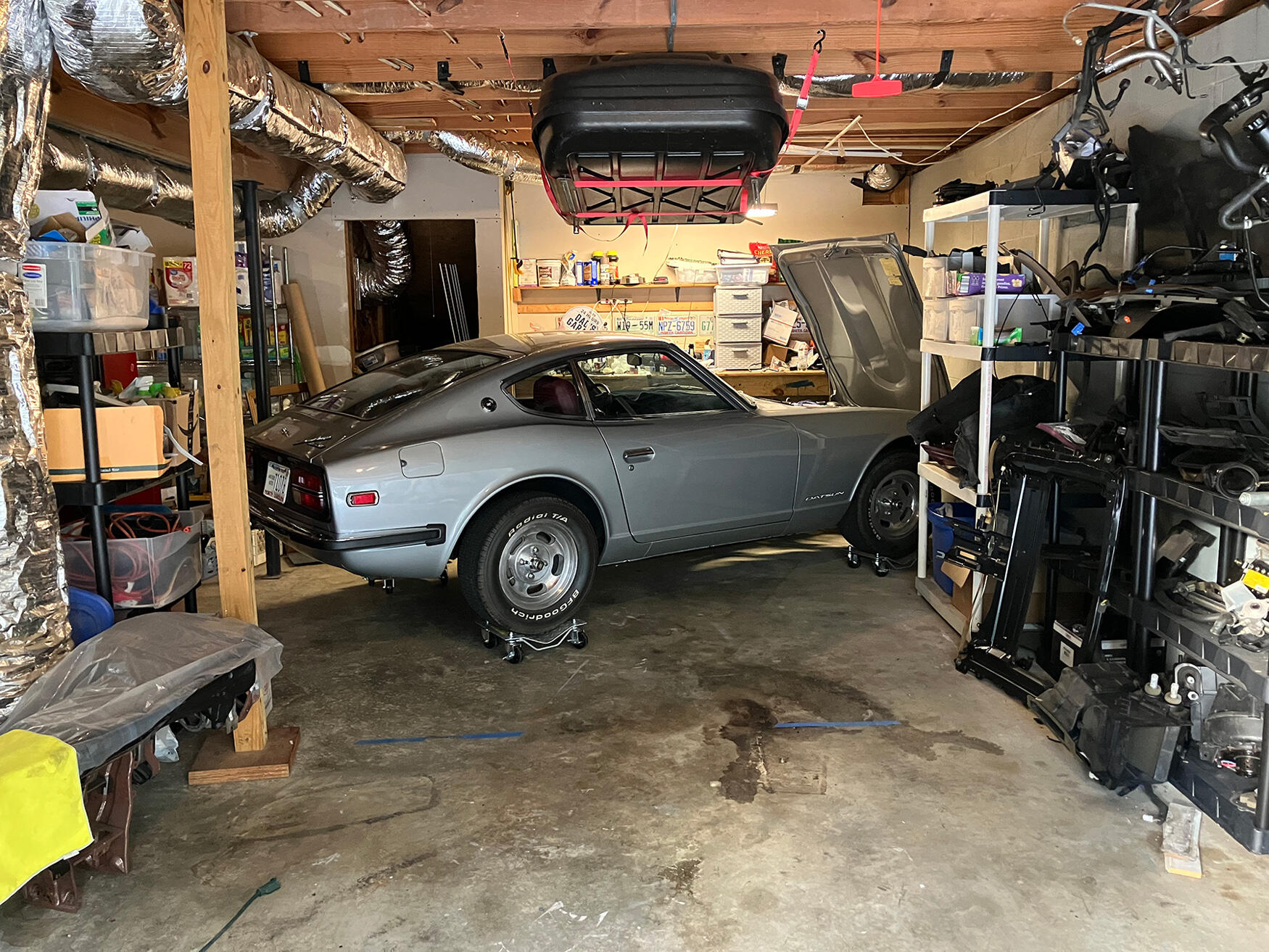

I put the car back up on dollies and rolled it back into its spot so I can get my daily driver back in the garage:
(a garage-mahal it ain't, but it works)
