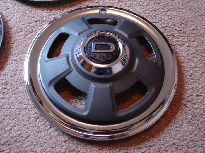

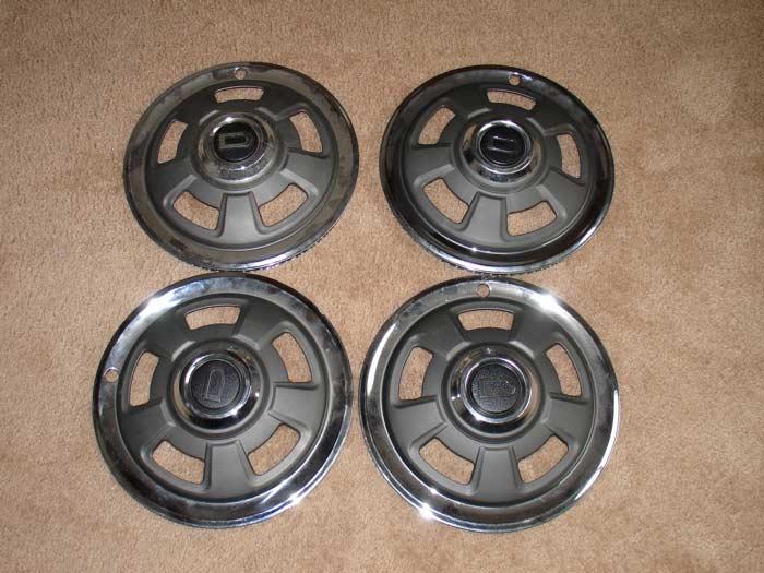

July 14, 20204 yr Author comment_602647 27 May 2006 - Lack of Focus Again OK, I did it again. This time I found something that sounded like it was too good a deal to pass up. I saw an ad in Craigslist in Portland for a set of four 240Z hubcaps and stock steel wheels, with an asking price that was very affordable. I e-mailed the seller and asked if they were the early or late 240Z hubcaps, and also asked if he had a picture. The seller (Ken) said he thought they were the early style, and the picture he sent confirmed that. Picture looked pretty good, too. So I sent him a check and arranged to have one of my new Z buddies in Portland pick them up for me. Bryan picked them up early in the week, and e-mailed to tell me he was keeping them. Ha ha, funny joke. He then said that he was jealous, they looked really good and that I got a great deal. On Wednesday, when he was down in Eugene on business, he delivered them to me. I got much more than I expected. This set of wheels and hubcaps were obviously removed from a late '71 240Z when it was brand new. The hubcaps are nearly perfect, and even pristine on the back side. The rims still have original Japanese wheel weights clipped to them, and again, the back sides are clean. (Just a bit of brake dust on the rear of two of them.) Now to be honest, I haven't yet decided what I am going to do with these. The stock wheels are only 4.5" wide, and factory size tires (175SR14) are very difficult to find now, and may be impossible later. But I could clean up the wheels and use a slightly wider size (such as P185/75R14) which would still be narrow enough to fit on the narrow wheels. While I have always assumed I'd end up with a set of period-correct mags on the car, having these hubcaps might be even more unique. Another option would be these hubcaps on a set of later 5 or 5.5" wide stock 280Z/ZX wheels with 195/70R14 tires. That would look about the same and give just a touch more width. On the other hand, this particular set of hubcaps are exceptionally nice - maybe too nice to be used on a daily driver, which is my plan for the car when it is finished. And frankly, they are worth a whole lot more than I paid for them. Selling them would go a long way toward cash for the engine rebuild. I have definitely got some thinking to do on this one, but I suspect I will end up putting them on the car. (But not until the car is pretty much finished.) Edited July 14, 20204 yr by Arne Link to comment https://www.classiczcars.com/forums/topic/64247-livin-z-life-historical-archive/?&page=3#findComment-602647 Share on other sites More sharing options...
