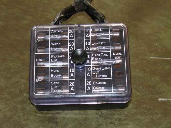

July 14, 20204 yr Author comment_602631 5 Feb 2006 - Re-wiring Begins I didn't know if I'd have anything to work on this weekend or not. But Saturday morning my replacement dash harness and fusebox arrived by FedEx Ground. They deliver on Saturdays? Who knew? Anyway, that was a good thing, as I didn't have much else planned for the weekend, other than watching the game. I opened it quickly, and was immediately pleased by what I saw. The fusebox was solid and intact, and the harness looked good at first inspection. All the connectors were intact, and no wires appear to be melted. Pretty much just what I had hoped for. So I straightened it all out, and began carefully looking at each terminal and connector. Comparing to my wiring diagrams, testing the wires, cleaning, etc. And I'm well pleased, it is a really good harness. That was mostly yesterday. I had some time before the Super Bowl today that was not allocated to anything else, so I went out to look at pulling the dash out of the car. Well, it turns out that pulling the dash on an early 240Z is not all that difficult, and it is upstairs in the spare bedroom even now. I haven't pulled the bad harness all the way out of the dash quite yet, still comparing and making sure all is right. The replacement harness is from a manual transmission car, which means that are no wires to connect to the kickdown switch, but I don't care, the transmission swap will be the next thing after the wiring. I've got all the gauges out too, and will clean them all up before I put it back together. No real surprises so far... Link to comment https://www.classiczcars.com/forums/topic/64247-livin-z-life-historical-archive/?&page=2#findComment-602631 Share on other sites More sharing options...

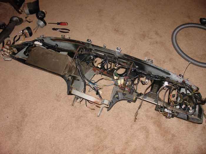

July 14, 20204 yr Author comment_602632 11 Feb 2006 - Reassembled Well, I swapped the replacement harness into the dash during the week, and put it all back together today. And boy, putting the dash back in the car is a whole lot more difficult than getting it out! But after much laying on my back, half in the car, I got it all back together. It turns out that the only difference between the early automatic and manual transmission harnesses is the wiring for the kickdown switch. So there is now one unused wire on my engine compartment harness, and I have removed the kickdown switch from under the dash. And how does it work? So far, so good. Everything that worked before still works. The clock even tried to go, but stops ticking after a very short while. I will test the rear defroster later. Still testing to see if there is a current draw pulling down the battery, but it doesn't look like it at this time. So far I'm happy. On another front, Deanna and I drove to Corvallis (about 50 miles one way) on Tuesday to buy a spare engine. I saw an ad from a lady there who wanted to sell what she thought was a really low miles, complete 240Z engine. She was asking $200 for it. I talked to her on the phone about it, and she admitted that her boyfriend said it was low miles, but she couldn't confirm that. She thought it was complete, but couldn't answer my questions about it as she knew nothing about engines. She lowered the price to $100 while we talked, and so I figured that the timing cover and flywheel were probably worth that much, so anything else good would be gravy. I found both more and less than I expected. Yup, it was an 2.4 liter 240Z engine from a '72 or '73. But it is far from the complete engine I had thought she described. It's not much more than a long block, actually. But it does have the flywheel and timing cover I need. It's not even close to being a runner, it's been sitting in the weather and I can see (through the sparkplug holes) some rust in the bores. So the motor is definitely less than I had hoped it might be, but that didn't surprise me. What did surprise me was when the lady told me about some other 240Z parts she found as well, that she would throw in with the engine if I wanted them. A miscellaneous bunch of engine and clutch parts for the most part, but also a pretty decent pair of tail lights, and a rear tailgate support strut that still has its gas charge! So the spare engine is still in the trailer while I figure out what I'm going to do with it. The tailgate support is on the car now (no more broomstick!), and I'm going to clean up the taillights to find out what I really have soon. (The chrome trim on the lights isn't perfect, but is much better than what's on my car now.) One last thought - on the way back with the engine, Deanna mentioned that this project seems to lack focus, when compared to other project cars I've had in the past. And she's right. I keep getting distracted by parts on eBay, or craigslist, or whatever. I need to stay on task, and not dilute my resources on getting stuff I won't need for months. ("Get thee behind me, eBay!") So before I move to the next task, I will wait until I know I've got the wiring handled. When that is done, then I will proceed with the transmission swap. Link to comment https://www.classiczcars.com/forums/topic/64247-livin-z-life-historical-archive/?&page=2#findComment-602632 Share on other sites More sharing options...

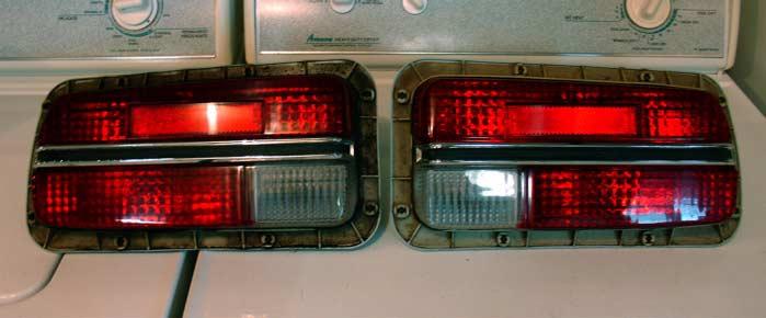

July 14, 20204 yr Author comment_602633 12 Feb 2006 - Quick Update Checked a couple of things briefly today. The first had to do with the wiring again, as I still worry that the dash harness may not be enough to fix all the car's electrical ills. But I have no evidence of that, all seems OK so far. For the first time since I got the car, I left the battery connected overnight, and the battery voltage did not drop at all. It still shows the same level of charge as it did yesterday. I will leave the battery hooked up this week, and re-test the voltage later. If it is still holding steady by next weekend, I can finally put this chapter to rest. I also cleaned up the pair of taillights that came with the spare engine. They are also of the same 1973 vintage as the engine, and cleaned up pretty well. The lights aren't as good close up as they look in the picture, but they are quite presentable, and much better overall than what I now have. As such, they will do fine for quite a while. The car is going to have to be pretty close to finished before I'm going to worry about finding any better ones, if then. Link to comment https://www.classiczcars.com/forums/topic/64247-livin-z-life-historical-archive/?&page=2#findComment-602633 Share on other sites More sharing options...
