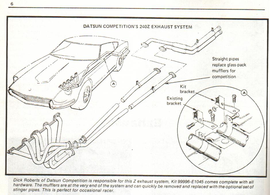

I was wondering if anyone had any experience putting a Datsun Competition Exhaust on a 280Z (1977 in particular).  From my understanding the exhaust mounting points changed slightly in the 280Z along with a smaller rear valence cutout for the tailpipe.
I've been mocking it up and I keep running into the same issue, it seems as if the driver's side flange of the end piece (That muffler assembly in the picture, the right flange) doesn't line up with the driver's side exhaust cut out like it seems to be designed for.  Instead it's around the middle of the car and forcing me to route that pipe in an awkward direction that makes it meet up at an angle.
Any suggestions?
