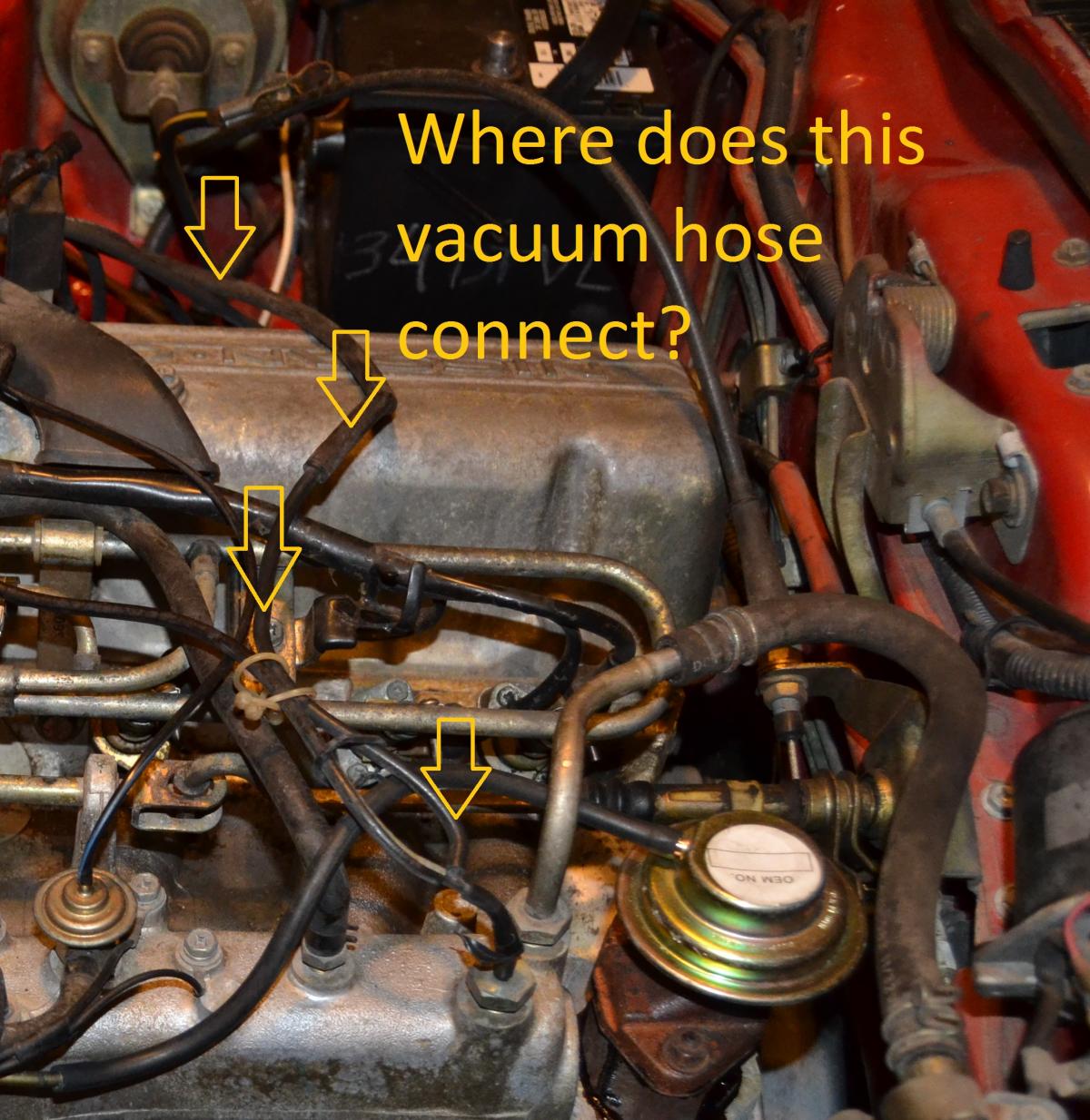

Where does this vacuum hose (see photo) connect from the T split (1983 280zx)? Does it connect to the cruise control actuator?post-30055-0-68070300-1426769097_thumb.j
On my '81, yes, one of the two small vacuum hoses goes to the Automatic Speed Control Device (ASCD) servo valve:
