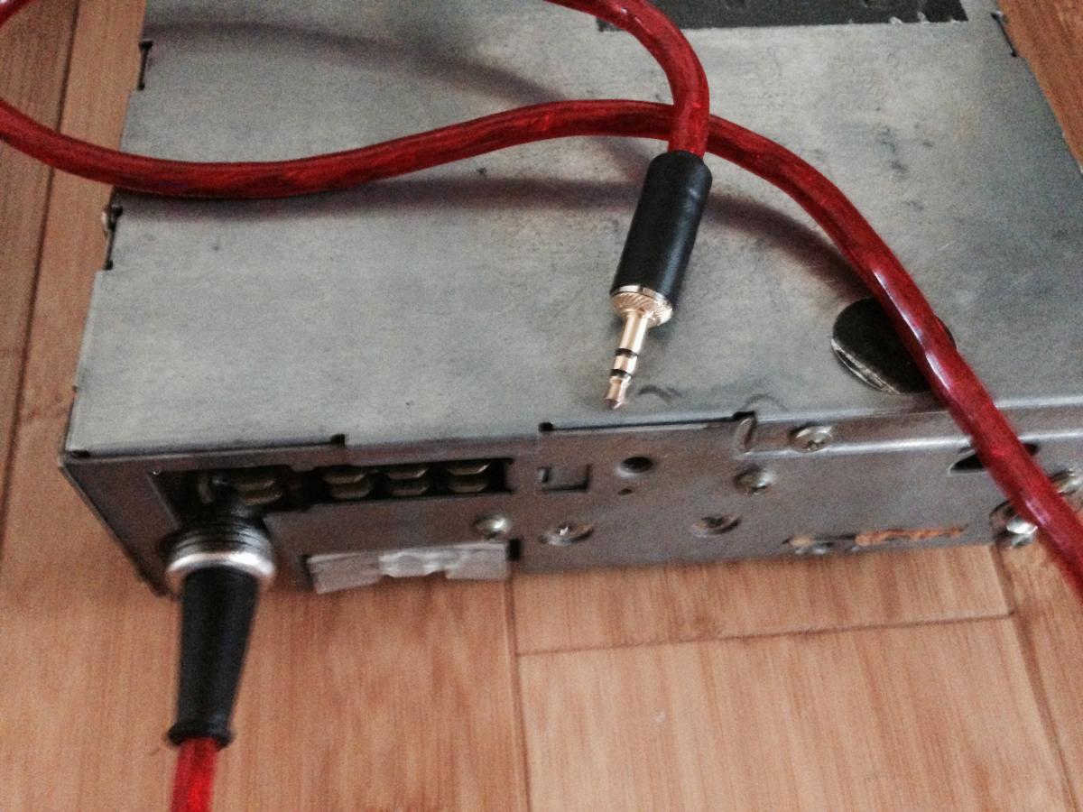

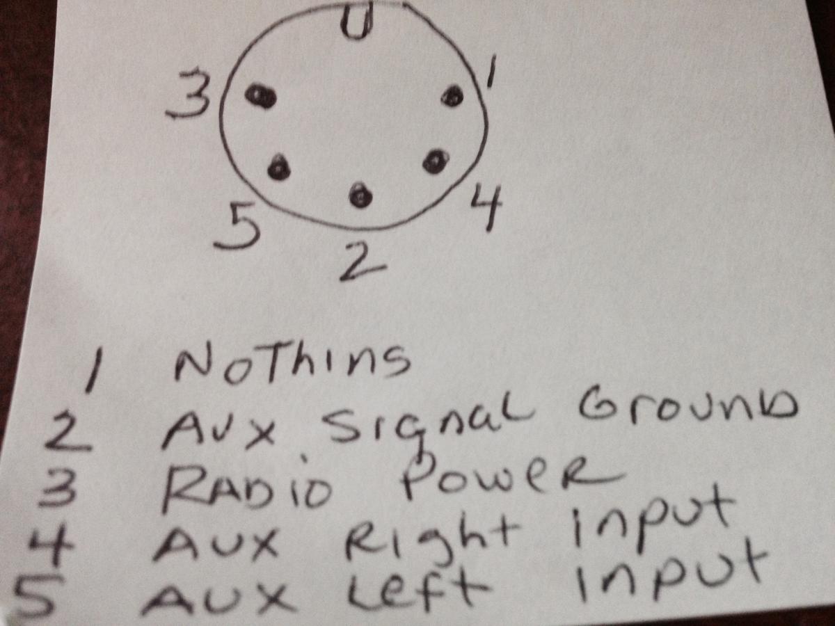

anyone done the aux in mod to their later model clarion/hitachi radio? this radio is from a 78
i was thinking of using the stereo signal switch on the front of the radio as my radio power switch to toggle between
aux and radio.  i wonder if that switch can handle the load and or possible arching?
post-23403-0-12551600-1419982856_thumb.j
post-23403-0-18681600-1419982885_thumb.j
