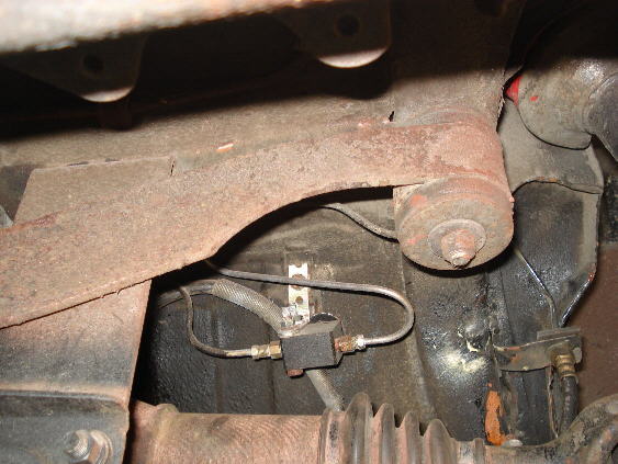

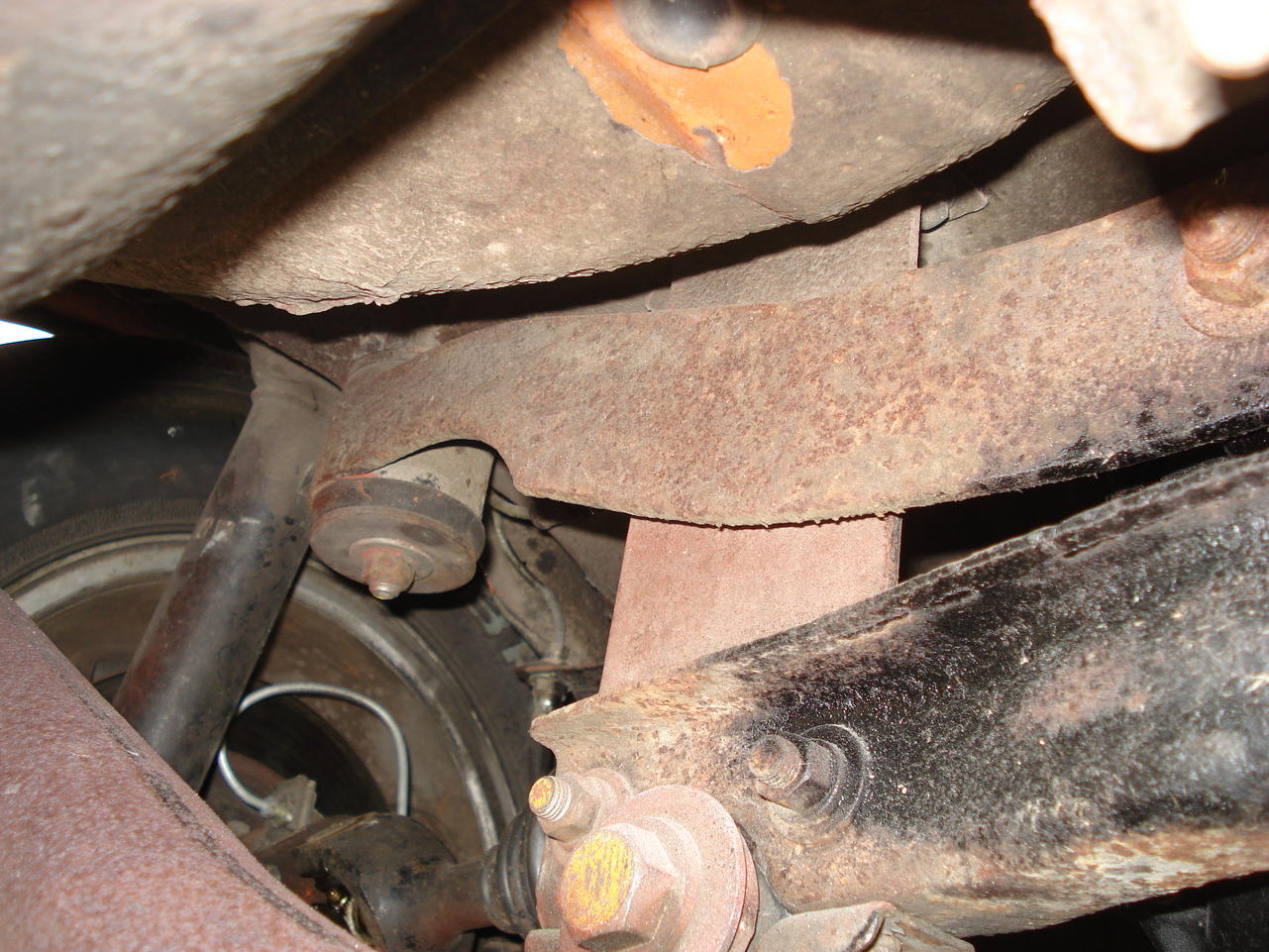

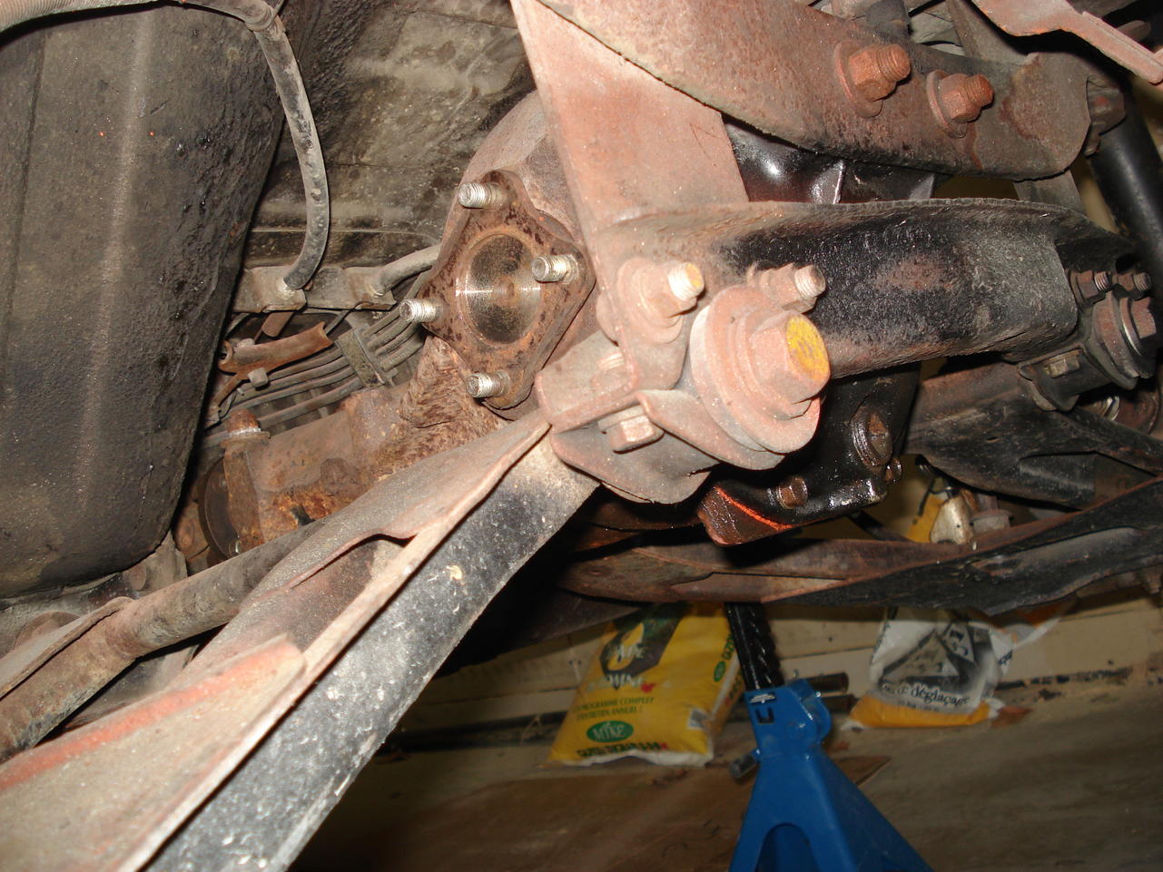

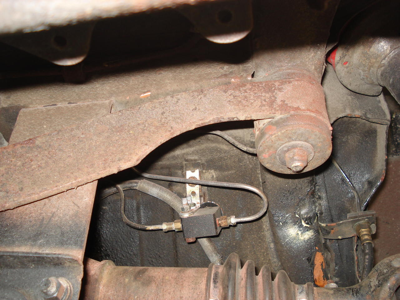

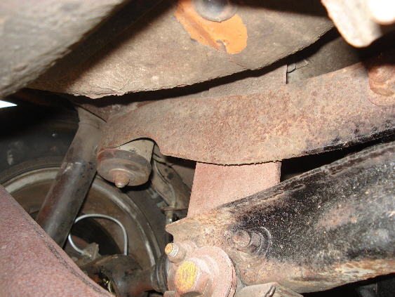

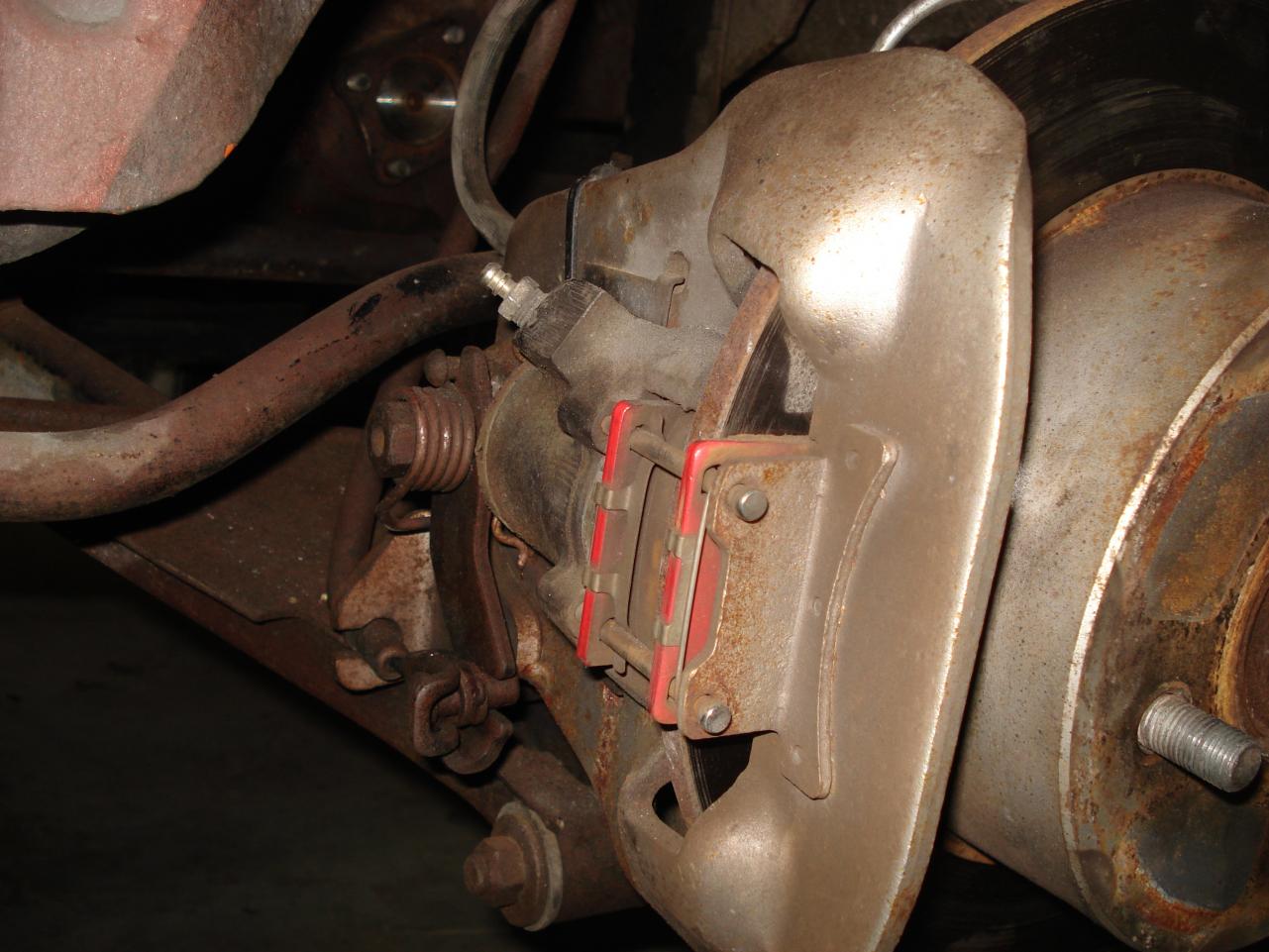

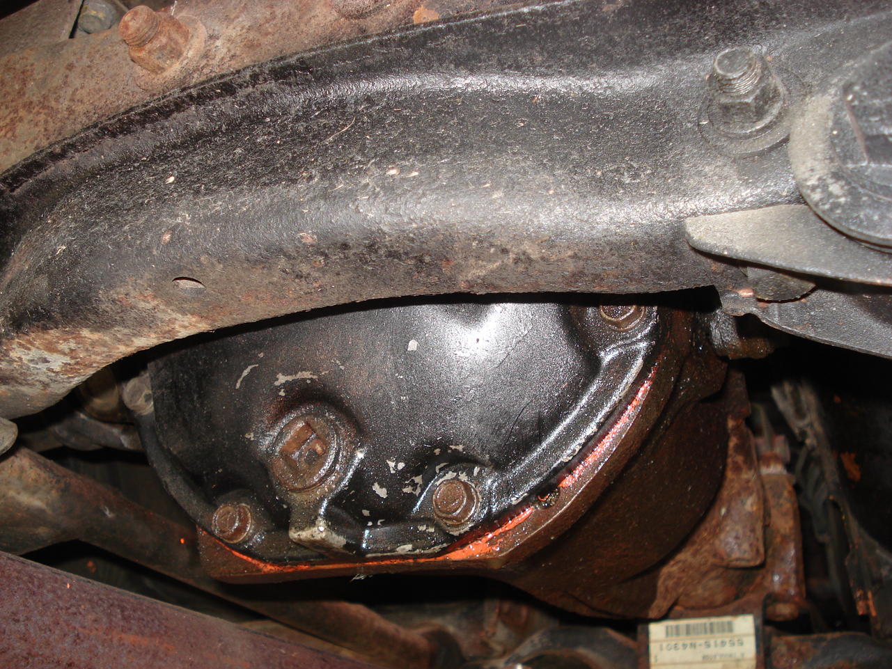

So here are a few before pictures
So started by jacking the car on candles highest that i could
Removed wheels, and muffler up to midle of the car
Removed brakes no broplem`s there

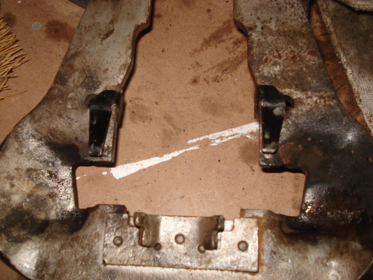

First battle was the spindle pins them they are hard to removed
had to call a friend made that easy we did cut them off anyway i do not need them anymore.

clean the underbody
removed every loose stuff underbody coating that was there from PO.
did not remove every thing some of this was very well bounded.

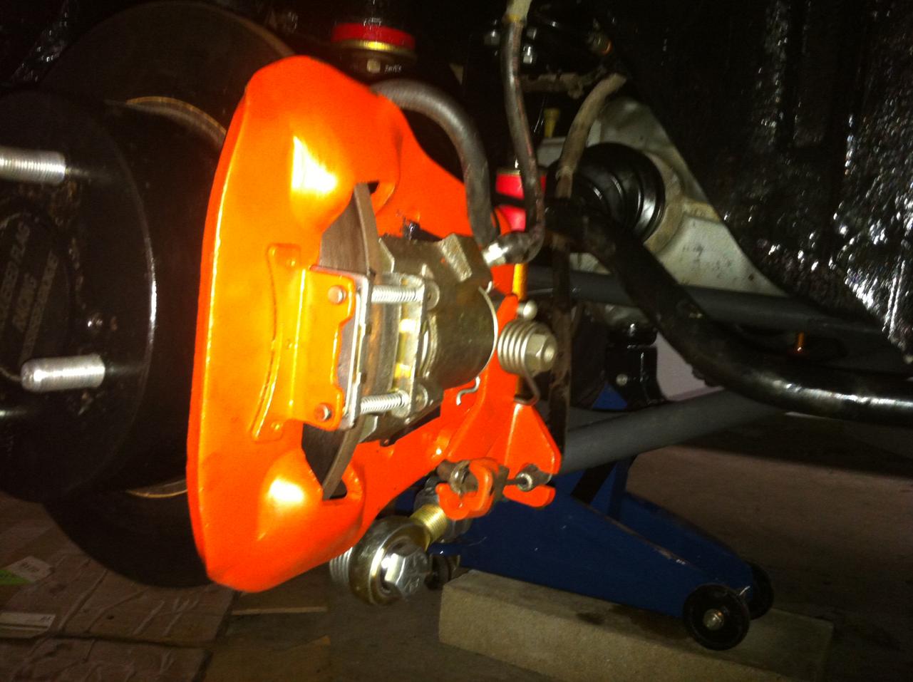

Rebuilt the brakes
then i found a used but almost new set on ratsun $75
So i used those they are in much beter shape than the one i had.

we went to put the Z31 axle in the R200 vlsd diff.
Keep on learning the yokes are to small.
So i found a guy that could rebuild my noisy CLSD with the
good part from the VLSD. cost me 90$ and i made a new friend

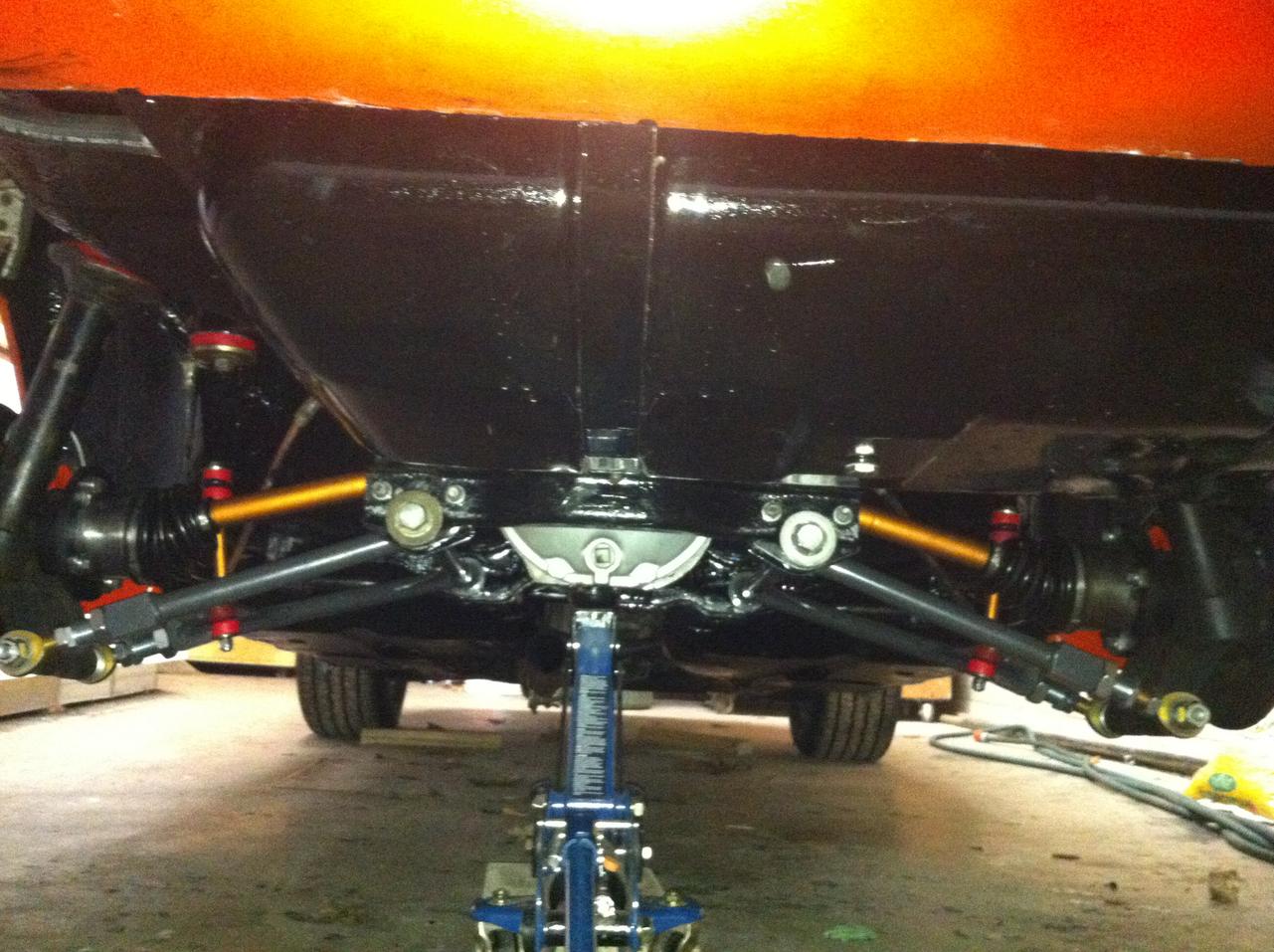

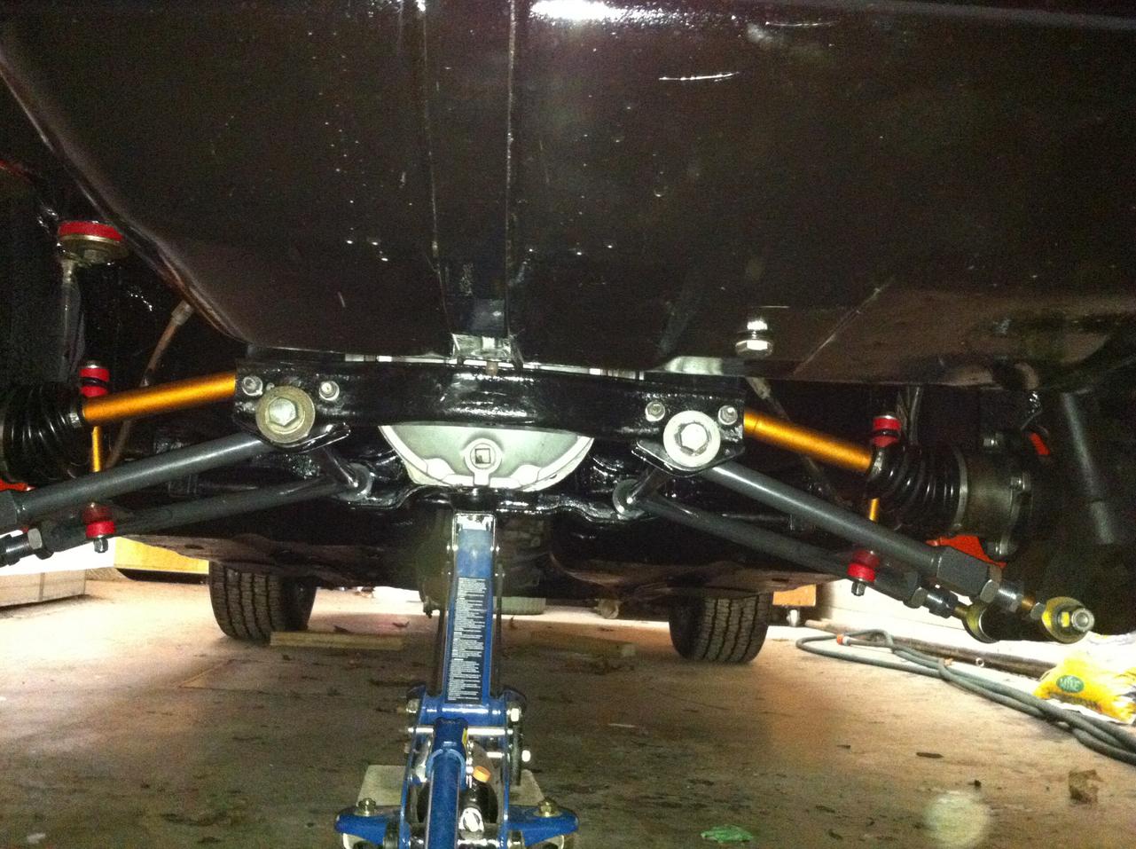

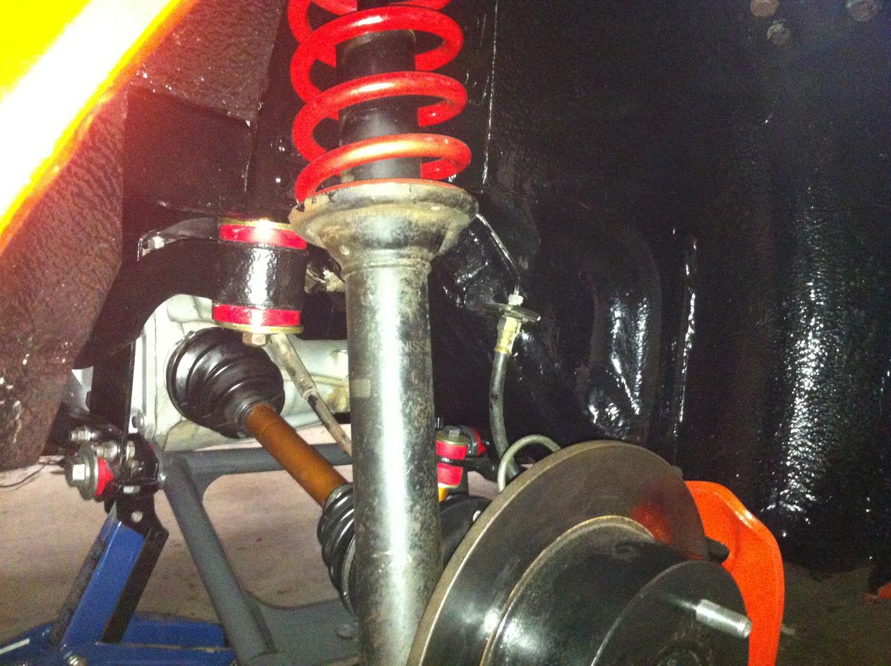

So realled m frien and we did put the diff under the car. lower control arms
I already had installed stub axle and companion flanges.

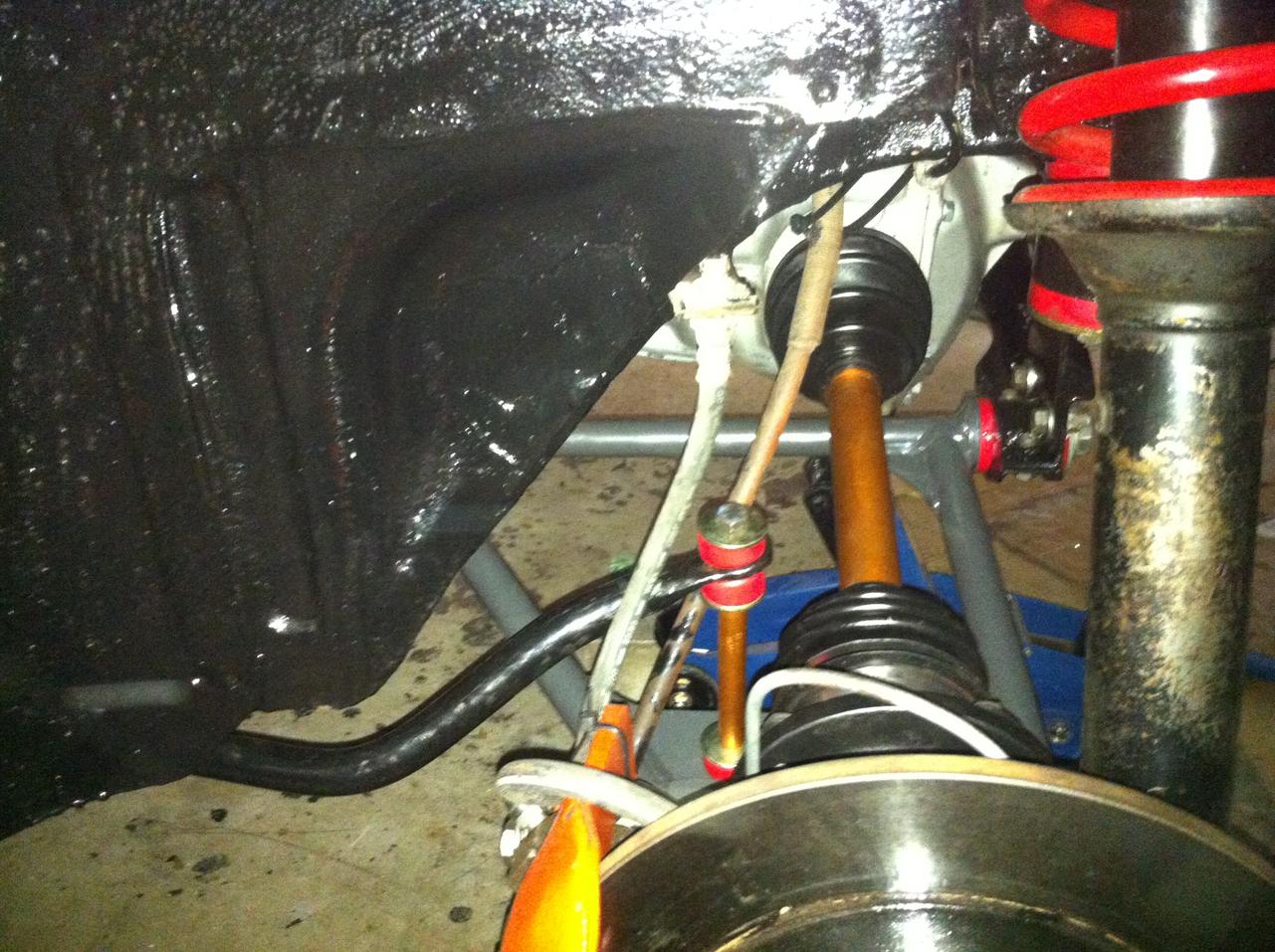

found that i need to push the wheel 1" out of standard to have these Z31 fit under
there and that the sway bar was touching the outer rubber boot on the CV'S
machined longer spacer paint cook the paint.

Here are the after images
