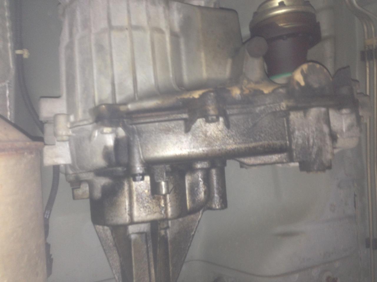

Case in point, I take a 2000 Grand Cherokee Limited 4x4 in for a pre-purchase inspection. I observe the transfer case is covered in oil and road grime. Top to bottom, front to rear. I even take a picture of it.
They diagnose a leaking "pinion" seal. They replace it.
When they go to top the thing up THEN they find the crack in the side of the case.
And expect me to pay for the repair/replacement despite THEIR mis-diagnosis.
