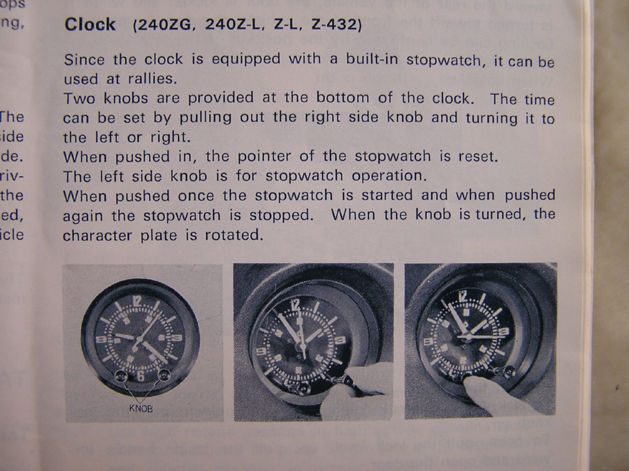

Hi all
What is the function of Z RALLY CLOCK with 2 knob ?
When have the power supply, run normally second , minutes and hours , as other normal clock.
right knob pull and adjust the hour ( example only 1 time in the year )
left knob run the black disk with the 60 second
but the chrono function ?
push right knob, what happen ?
push left knob what happen ?
other ?
If you use the search function on this site you can find your answer, but here is a page from an english version of a JDM owners manual that Kats posted a few years ago. It shows how the clock operates.
-Mike
thank you for photo
some questions:
I don't touch the 2 knob, I think the clock run normally.
When run normally, the white pointer of hour and minute turn - run .
The orange pointer of seconds , always run concurrently with minute and hour ?
or standing still?
when the left knob is pushed ,the charachter plate run / rotate , and is stopped when repushed for 2° time ?
The motor inside the clock, run with 12Volt , with 5 volt or other tension ?
What is the shape of wave , for the motor ?
example 5volt for 1 second ?
