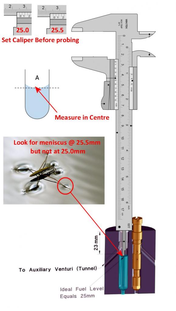

<<< USE 29mm rather than 25mm >>>>
25mm causes a huge rich spot when cruising at highway speeds!!!!!
Use a flashlight when probing.

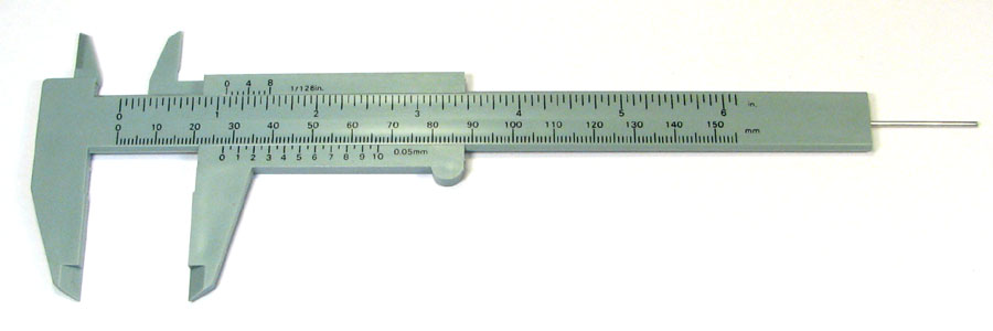

I like to use these dollar-store-tool-section calipers.
You can buy two and lock one at 29.0mm and the other at 29.5mm for go/no-go probing.
