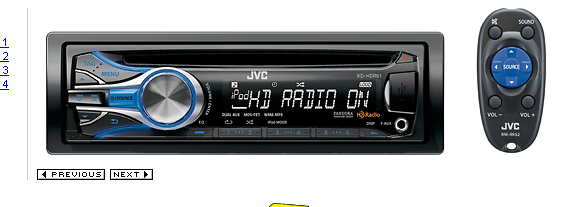

Today I put together and bench tested my new audio setup.
Includes a fancy new JVC headunit, with Ipod controller, bluetooth, HDFM, everything, including a remote control I might try and mount to the steering wheel...
I'd always gone with Sony & Pioneer (staring with my very first SupertunerIII) but the JVC's controls were more intuitive... I prefer NOT wrecking cars while figuring out how to balance the speakers...
http://www.bestbuy.com/site/JVC+-+50W+x+4+MOSFET+Apple%26%23174%3B+iPod%26%23174%3B-Ready+In-Dash+CD+Deck+with+HD+Radio/4707067.p?id=1218512779392&skuId=4707067
