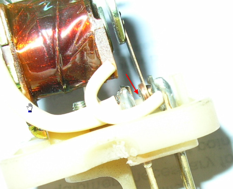

Well, I just pulled down the relay, swapped it actually, and dissected the old one...
And THERE IT IS. Right on the contacts is a tiny hi spot where metal has transferred from one contact to the other over time, preventing full and complete contact. That little "whisker" will also get oxidized over time and become non-conductive, unless the contacts are pure gold. Probably not, on a Datsun.
The solution? An emery file or emery cloth to burnish the contacts a little.
So there it is, a 15 minute fix to an intermittent blower fan.
