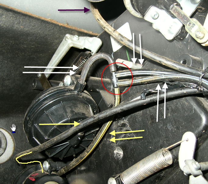

The vacuum lines have stripes on them, white, yellow green, one or two to help you identify them.
Vacuum from the underhood storage reservoir goes to the vacuum selector (round thing with 8 hose barbs) "S" for source, hose with red stripe.
Yellow/ 2Y goes to the bottom, or "floor" door mechanism. If you get the two lines reversed, I'm not sure it matters, what it gives you is stage 1 and stage 2 of door closure.
The green / 2G lines goo to the fresh air intake door above the blower motor.
The white and 2 white go to the main vent door on the left hand side of the box.
The other vacuum "motor" on the left side of the box gets the plain black hose, which connects to the control switch in the lower dash panel.
The "diagram" doesn't EXACTLY show you how all this is done, for instance there was a 3-way fitting on my 2W hose to split it between the vent door, floor door, and dash knob.

Annotated... red circle indicates a 4-way fitting.
The single yellow stripe was on the BACK of the hose pictured, I couldn't twist it AND hold the camera at the same time...
The actuator above the TOP of the picture (not visible) is the "bypass" actuator controlled by the little vacuum switch in the dash, below the ignition switch. Hose is all black.
There must be a single white line to the back of the vent (main) motor (not fresh/recirc) but it's not visible in the photo. Hmm, I wonder if it has fallen off...
