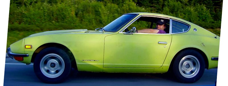

P.S. Here is no-load fuel flow at 3000rpm and 800rpm:
I drove the car for 600km no problem.
btw that fuel line ran along the outside of the car to the fuel door then down into the fuel tank as the hard lines were plugged.
It had black duct tape over it so it looked like a racing stripe.
