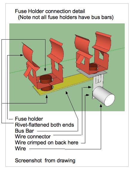

So, for the general audience, the moral of this diatribe, do the maintenance periodically by cleaning those fuse terminals and the fuse ends themselves.
Just keep in mind that cleaning your fuse holder contacts - will not save your Light Switch. The best solution is to relay the headlights - and lower the voltage going through the switch and fuse box to begin with. It is a very simple fix.

Thanks Carl B.
I'm learning very quickly from you guys. I've heard about the headlight deal, as well. I thinking, this Z cars wiring is far worst than Lucas! LOL!
I took each fuseholder out and soldered both ends of the rivets and the connections each wire made to the fuseholder assemblies. I also did the headlight relay upgrade to make the headlight switch last forever. I also soldered the two heavy white wires to their connectors (alternator and battery wires I believe) that are plugged together above the passenger's right knee area (USA models) and then plastered them inside with dielectric grease. The clear vinyl covers of those two connectors showed signs of overheating (black) giving me a clue they needed attention. I sure can see the wisdom of other routes such as fuse box replacement.

This is a drawing I made of what I saw when I took the fuseholder assemblies out:
