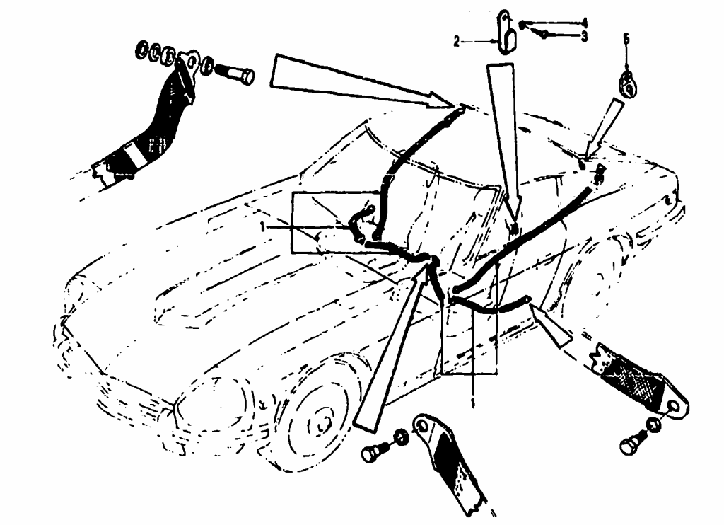

Finally!! Tomorrow night I'm going to have my original series 1 seatbelts re-sewn/re-assembled with the CORRECT clips/hardware. The question I have now is: Does anyone have photos or info of the hardware required and the position where the shoulder strap gets anchored to the interior? Additionally, photos of the finished installation of the coat hooks would also be appreciated. These seatbelts have been out of the car soooo long that I can't remember where to anchor the shoulder straps and coathooks. I hope I still have the correct mounting hardware.....any info on the proper bolt/attachment hardware would also be appreciated.

Blue, once again you come through! You're a veritable repository of Z related photos, illustrations, tech drawings, and general info. Am thinking your man cave must resemble more of a library than a traditional place where boys store their toys:)
Thanks again for your help. With this illustration, I could be mere hours away from being legal!

Do you think that the bolts that secure the belts to the transmission tunnel would be same size and length as the ones that secure the shoulder strap to the interior?

Just did this and had all the original bolts in the original locations. Long bolts in the B pillar the shorter ones in the tunnel and base of the door. HTH, Richard.
