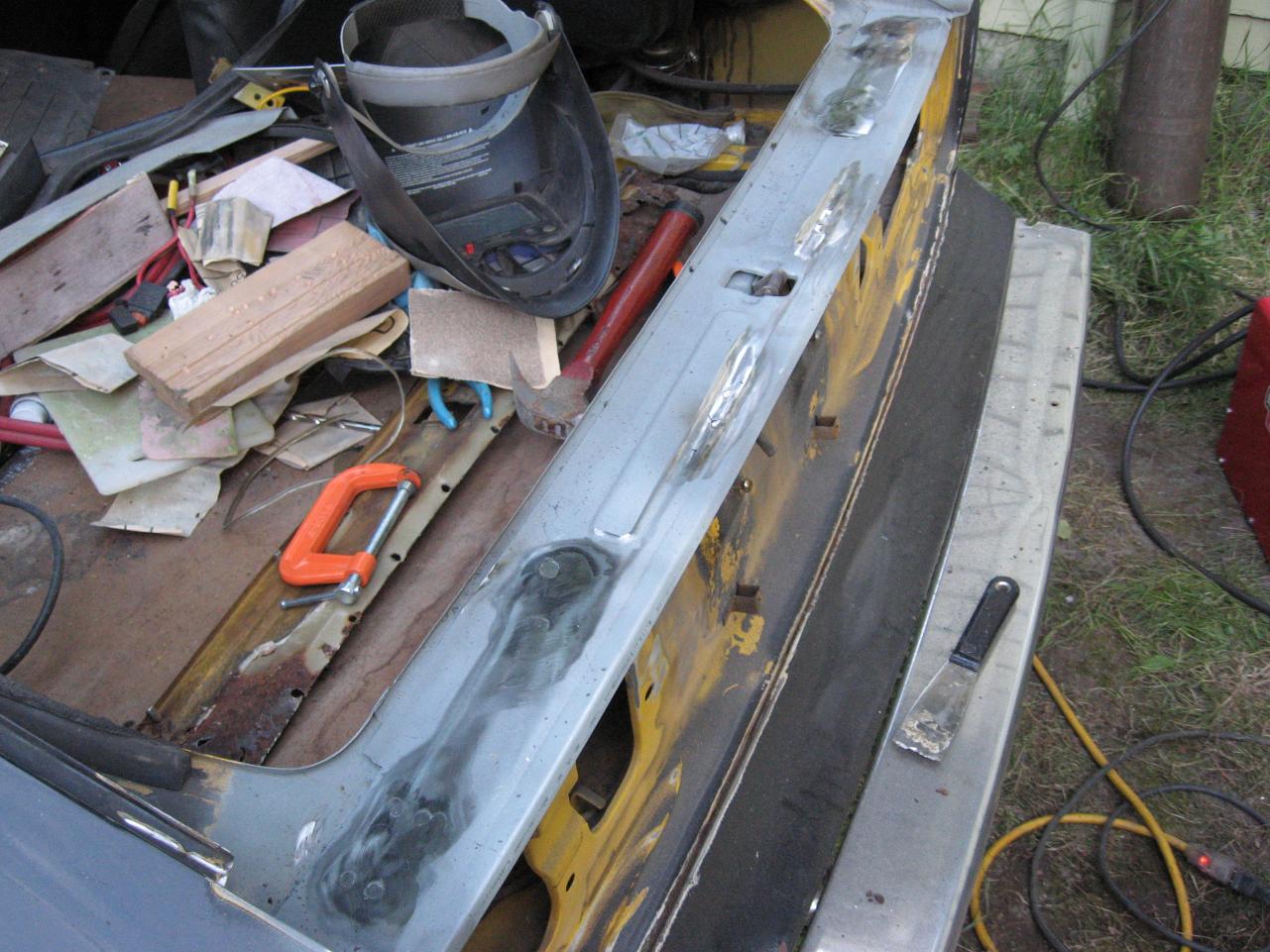

I also had to order mine from MSA $$$ but it worked out preatty good. you can see were it was a bit short for plug welding like the original at the forward edge, so I had to weld along the edge to make it work, this detail is hidden under the weather seal.
