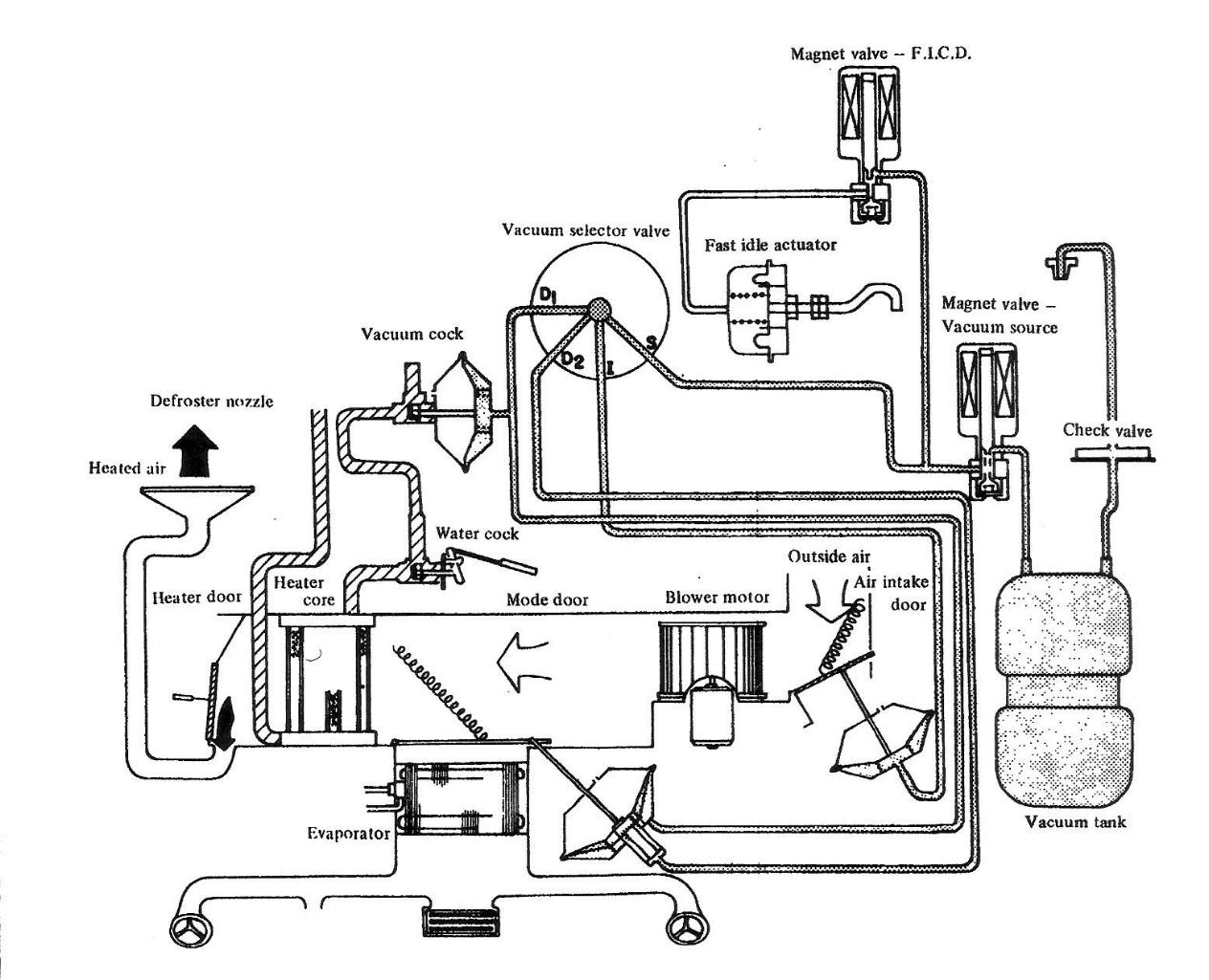

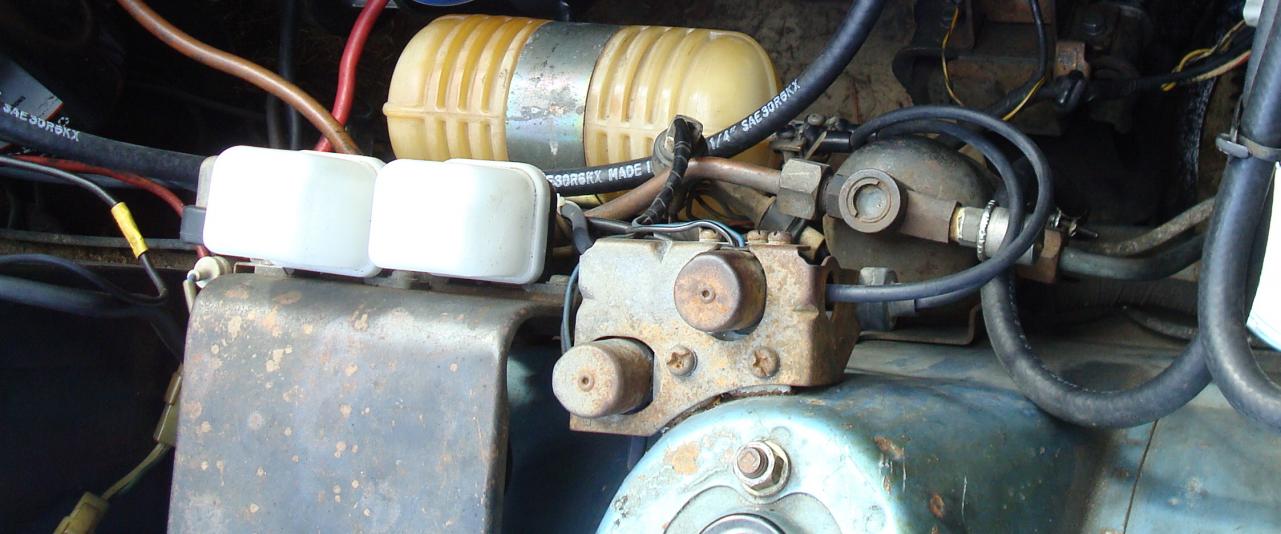

Easy things first before i start disassembling my ctr council, i replaced all the vacuum line a few months ago trying to get this old bird to idle smoother, when i went to hook the ones up that connect to the vacuum bottle, one of them goes thru the passenger wall to the ac/heat control unit, i was not sure which went were. I must have a million pic's of the engine before and after to help me prevent this from happening but none of the vacuum bottle. Does it matter ? does anyone have a picture showing the hose hookup.

Thanks sblake01, thing's seem to work better when they are hooked up correctly, not sure how i got the vac source crossed but that is what was wrong. I have great heat now. :classic:
