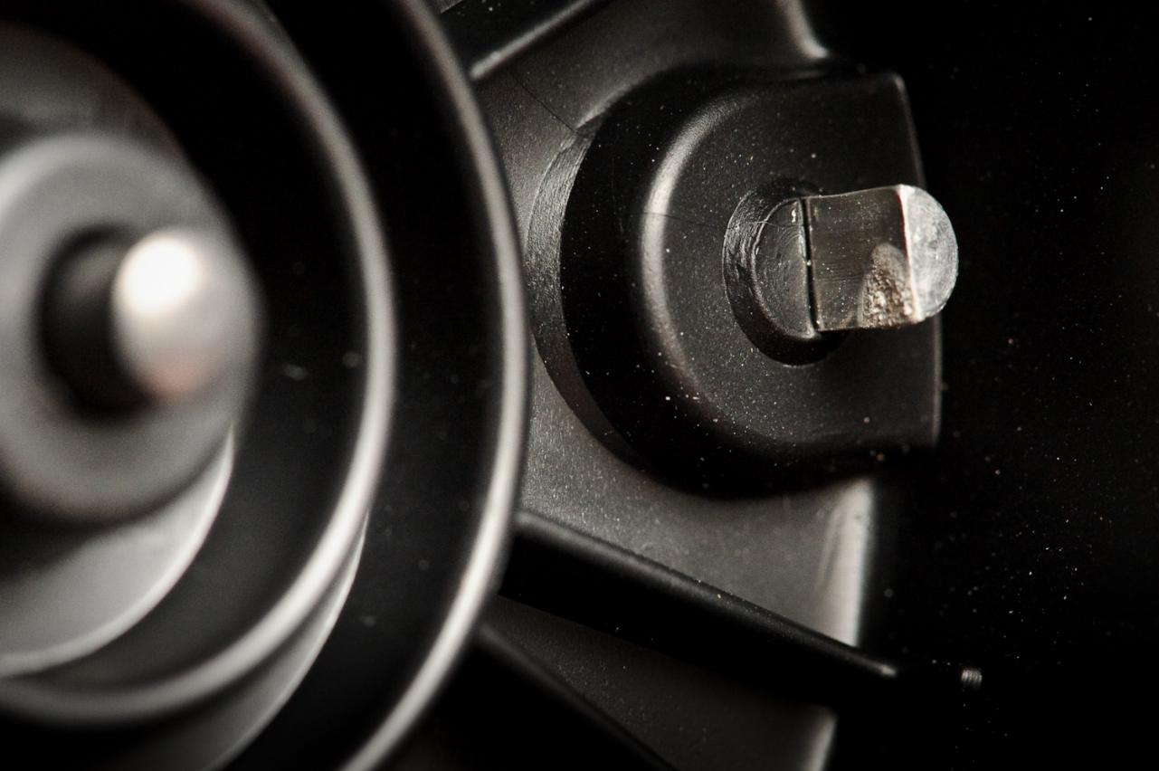

While troubleshooting a stumble at 5000 RPM I found what I think is an uneven wear pattern on the inside contacts of my distributor cap.
Does this look normal?
Looks fine to me. All that means is that the sparks are jumping more on the lower end of the terminal (with reference to the photo) than on the upper end. There's nothing excessive about the terminal erosion in the photo.
I agree, typical wear. All of the posts should look like that, and the edge of the rotor will have some pocking to it. Nothing in that picture to cause a miss.
