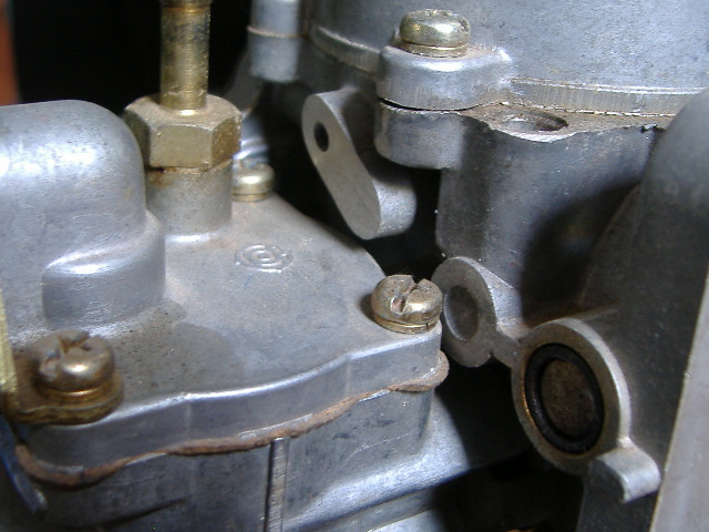

New carbs (1980) 4 screw front, 3 screw rear, 96 miles on them then the car parked 26 years. Looked in front bowl, after gasket fell apart in multiple pieces, full of varnish. Tried getting rear lid off for 1/2 hour until it was decided surgery was needed. Trimmed enough to get the lid off, full of varnish and gasket parts.

What did you trim to get that cover off? That's exactly what I'm curious about.
I didn't trim the lid. It was the ear with a hole sticking out above the lid. It is about 7mm long now, started about 12mm. I sold a set of 3 screw carbs and never thought to look to see if that ear was on them. :stupid:

That's ezzakkly the protrusion I'm referring to, thanks! :) I wonder if that was part of the internal boring process that they later figured out could be done differently. I'd bet that there's a ball bearing plug at some point in that little hole; anyone know for sure? I can't smash my face down next to the carbs close enough to look.
