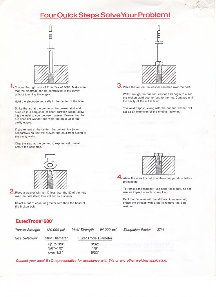

April 25, 201015 yr comment_317148 Generally, welding a bolt out is the quickest way to remove a broken bolt or stud, especially if broken off below the surface. Full Disclosure: I retired from this company 4 years ago. Link to comment https://www.classiczcars.com/forums/topic/35632-bolt-size/#findComment-317148 Share on other sites More sharing options...
