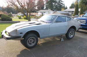

Hello all! I recently bought a 77 280z. Previous owner was doing a restoration to it.Interior is great, no cracks in dash or console, all panels in good shape too. Just needs carpet and new seats. Body is straight, just a few rust spots to contend with. Motor was replaced with one rebuilt with 10K on it. It started fine, idled a bit rough, when I give it throtle, the response is very slow and it will make a pop sound from the front. The rpm gauge slowly goes to about 2 thousand and then stays, doesn't move with engine rpm. Tried to drive it and it bogged and died. Won't start now. Has new battery. I'm an idiot about fuel injection, have no idea where to start with this. Here's a pic of the car.
