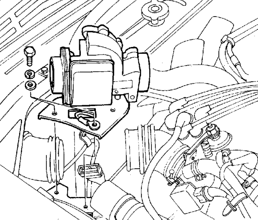

the main relay click once when i turn the car on and it click once when i turn it off. the pump was working befor i took the intake manifold and exhuast. where is the AFM located and how those it look like. is the big piece by the air intake
Thats the one, the AFM sits inbetween the air cleaner and the the intake manifold. (See image).
When you switch on the ignition, can you measure a voltage at one of the two pins of an injector and ground? If so, then the AFM is most probably the issue, as Tyler posted.
If you cannot measure a voltage, then you should check the relays next as described in the fuel injection troubleshooting guide.
