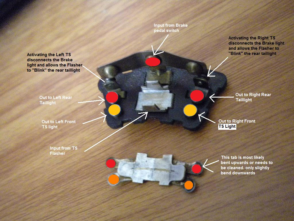

The RR and RF turn signal are connected together inside the TS switch when you activate the Right turn signal. So if you're activating a right turn via the switch, both RR and RF (green/black and white/Red) should show the same voltage and signal (+)

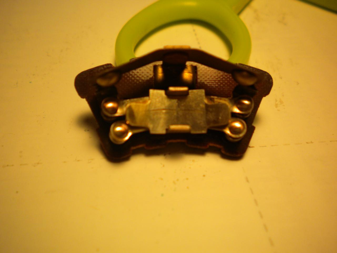

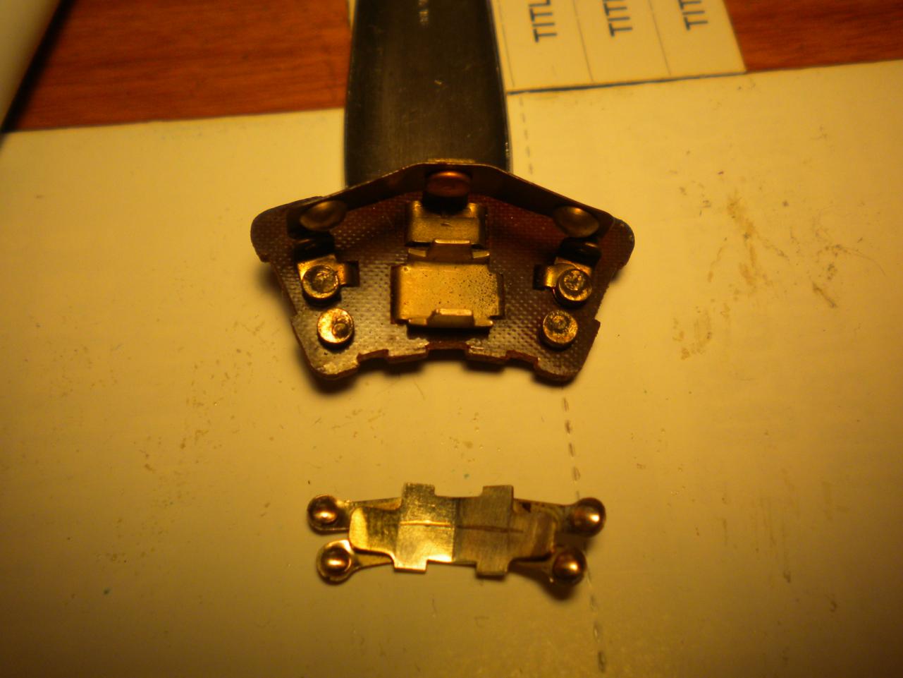

I've attached a few pictures of the Inside of a Turn signal switch. As it sits in the pictures, you'll see what contact goe to what corner of the car. When you activate the turn signal, the brake light contact disconnects from the rear contact, so the t/s can go thru that same contact and blink with the front light of the same side.
The first picture was written on for another customer, who had no rear turn signal but everything else worked fine. He rebent the tab correctly and all was good.
let me know if this helps and if you need the switch needs to be rebuilt. It's what I do.

Dave. On the TS switch, is the right rear WB or WR. I have been squinting at my Haines schematic for hours. Also, there is a single green wire on the TS switch that I can not find on my schematic. Any idea what the green wire is for?
Thanks
Miles
The right side wires are Green/black for the front right and white/red for the rear.
The left side wires are green/red for the front left and white/black for the rear.
Your diagram doesn't usually show the switch wires, but usually shows the wires up to that connection. The Green wire (center of the turn signal switch = Flasher) connects to a WHITE wire that goes directly to the flasher under the dash. You should be able to find the white wire on the diagram and the other wire on the flasher module is green.
That green wire on the T/S flasher goes to the hazard switch and then to the fusebox.
Hope that helps.
Dave
Solved the problem. There was no power at the red and white wire on the TS switch. So I took the switch apart and cleaned all of the contacts. Both rear TS now work.
For the right front I knew I had power at the turn signal switch. So I pulled the RF TS/Parking light harness connector apart and pushed it back together firmly. The RF TS now works.

Had a similar problem: Rt rear signal not working. Used your comments and photo, removed turn signal assembly, cleaned the contacts, and rebent the tabs..works great. Thanks for help!
When rebuilding switches for people, I run into this issue more often than not. I don't know why it's mainly the Right side and more often the rear than the front.
Use only a dab of Dielectric grease on the area that the ball bearing slides on. If you use a different lube, it'll likely heat up and move onto the contacts, causing them to fail or smoke the grease. The dielectric grease will allow it to continue to work without issues.
Glad it worked for ya. Be careful when bending tabs on the switch box, as they don't like to be bent too much or too often. They Will break after repeated bending and then I'll have to sell you another box.
