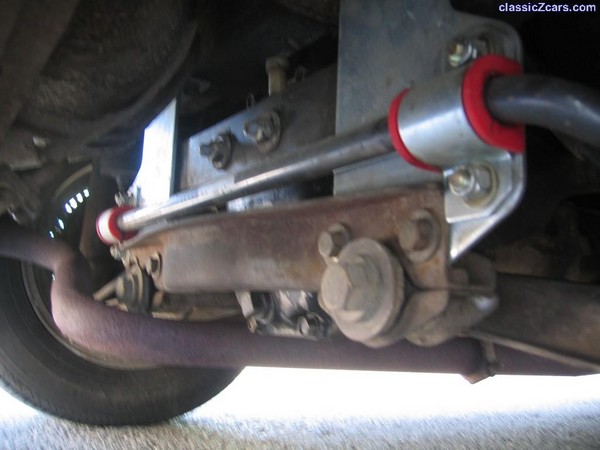

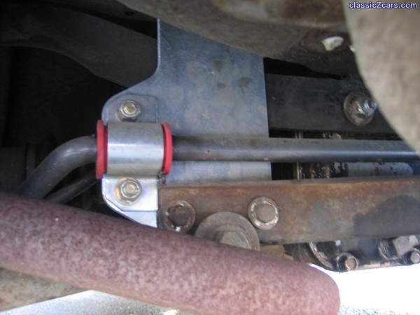

I found these photos on my PC, dunno what kind they are, just thought they were MSA type
Suspension Techniques. I like them because the center supports are real solid unlike some other manufacturers.

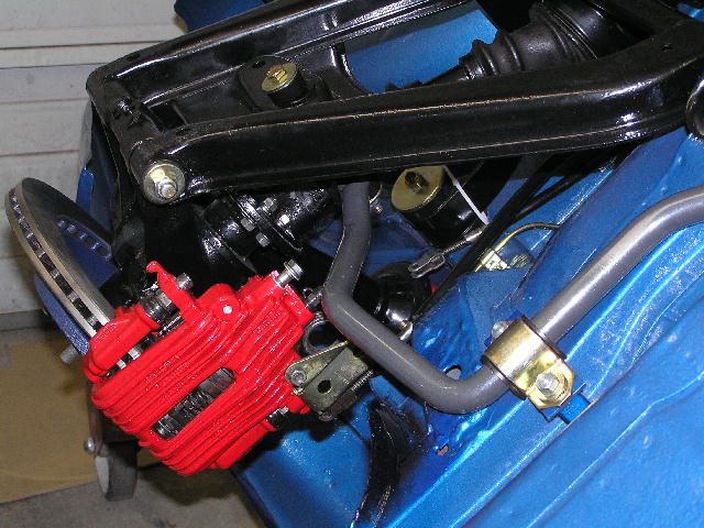

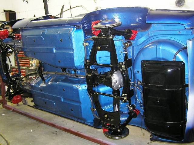

Here are some pics of my installation. Hope this is what you need.

Zsaint-that looks like the bar I have. I'll have to blow the pics up for detail. Did you have any interference issues? It looks like the bar sits slightly above the cross member that the diff sits on.
By the way, that rear rotor conversion looks nice. Was there much adaptation required for that? Were you able to use the original master cylinder?
The bars fit on w/o any interference. No problems.
These are Corvette rotors and calipers.(90-96) I did use a 15/16 M/C. (reverse brake lines, F & R) The only trick was the emergence brake cables. Had to design a new system for the cables. I would not want to try and hold the car on a 20% incline! The Z E-brake holds OK on normal roads, however.
