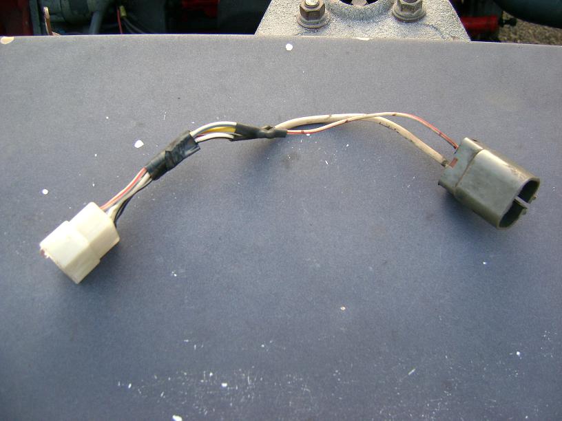

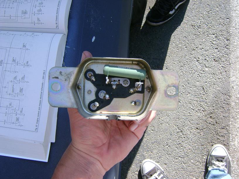

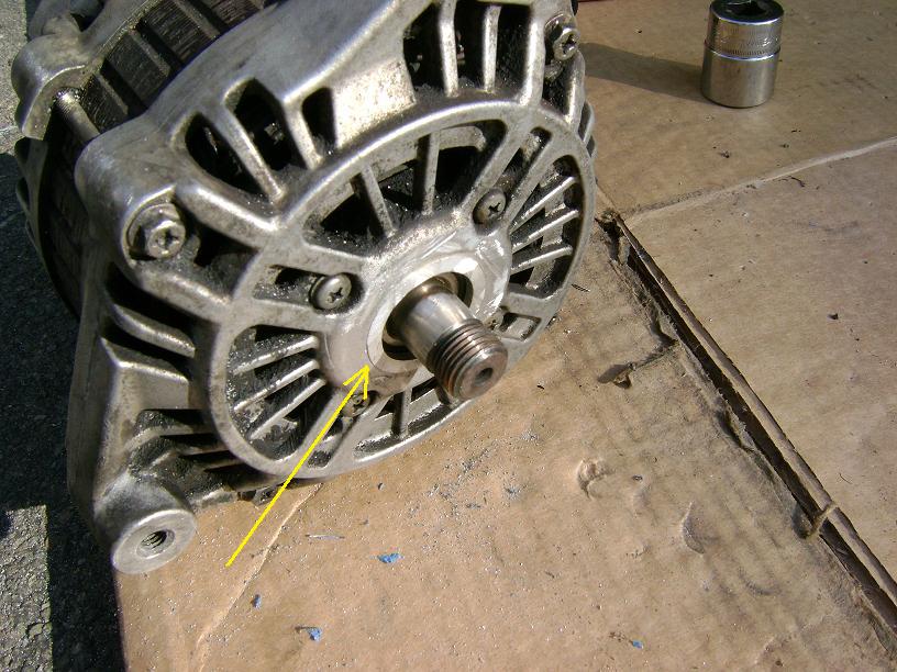

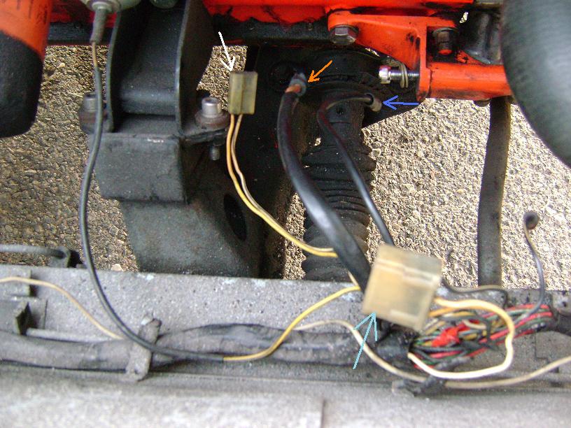

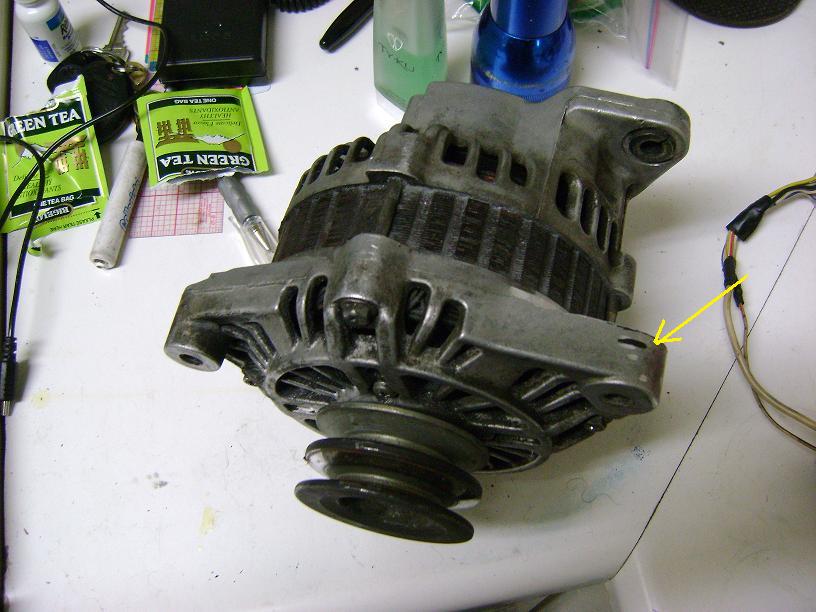

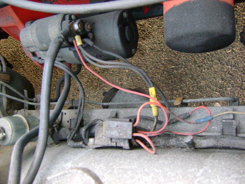

So anyway here's where I am at with the project right now. Alternator is almost done modifying just need to grind down a little more to get everything to line up the way I want. I'm thinking an 1/8 of an inch or less, already removed about a 1/4 with plenty of support area to spare. I haven't started the wiring since I've been sick and busy the last few weeks (was really hoping to have this finished by now). So here are some pictures like I said of a few of the things I've done while doing the upgrade.
Ok the first picture shows the alternator after I got it and cleaned it up the arrow points to the lip on the front, that will need to be grinded down to be flush with the rest of the alt.
Picture 2: show's the after math and what it will look like you will need to get a spacer to fit around the shaft to prevent the pulley from rubbing against the facing, I will get a picture of this so everyone can see.
Picture 3: Is the back of the external regulator after I cut off all the wires to make the harness to connect to the new alternator.
Picture 4: Is the new harness using the leftovers from the regulator harness and the Nissan Maxima Alternator plug, I used this one because the wires were thicker than the Quest wires however the units are identical other than that.
Picture 5: The stock wires RED=power BLUE=ground WHITE=alternator connector LIGHT BLUE=external regulator
Picture 6: The alternator together and you can see the mark where I'm going to grind down some more metal, maybe don't even have to grind down as much as I've marked.
Comments about this are appreciated, especially if you notice something I've done is wrong, LOL.

Well I have good news the swap to this alt is a success.....so far. I finished earlier tonight after many trips to Kragen (couldn't get the right belts). Car starts and runs just fine. I didn't have to install the diode...so far I may need to later but as of right now it's not needed. I'm also not sure the car is charging yet either I don't have the tools to check it so I will have to test it tomorrow. If this really works I will be sure to include everything I've done to help anyone that wants to do this conversion.
I also wanted to thank everyone that gave me their input about this everything really helped the project.
